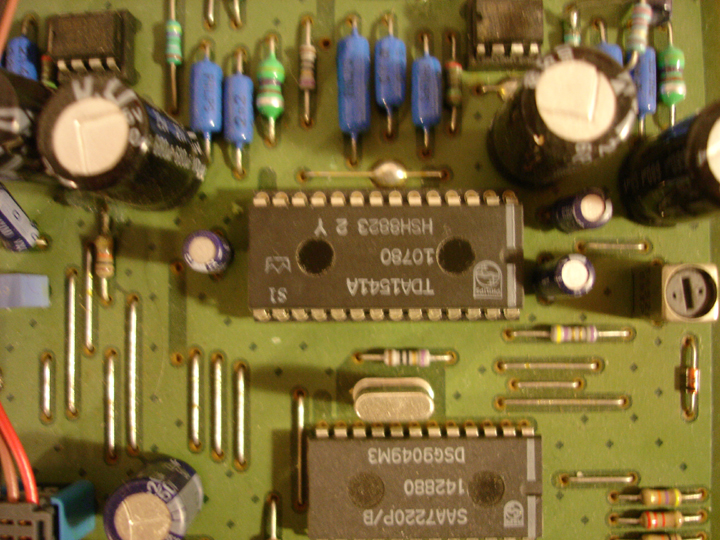

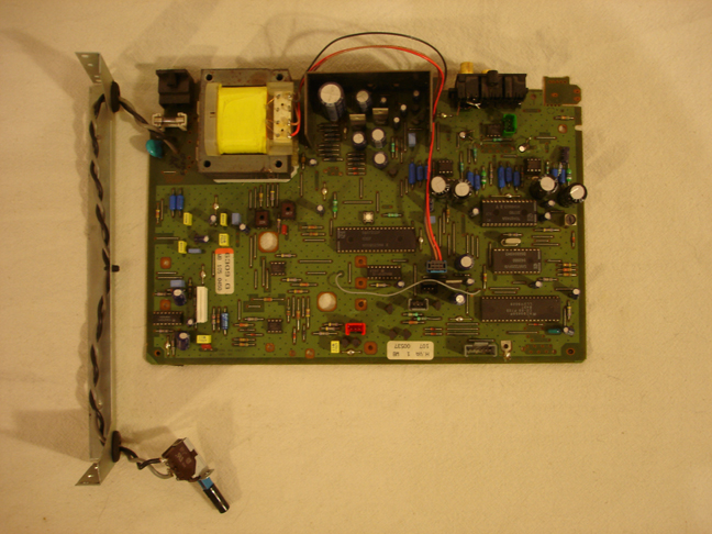

Need help to find digital input in Hafler Iris cd player.This is classical philips machine.Saa7210p,Saa7220p/b and Tda1541a, with digital output.After it stop spinning I thought it can be good dac.I will use Sony playstationI as transport,any input will be very helpful🙂

Maybe,better way is deicated transport with I2S, can you help me find where is digital input,...where to look?
Why not repair the original machine?
Its a basic Philips model with a single crown TDA1541A
CDM4 drives are readily available although it is more likely to be the 47uF cap giving trouble - VERY common

Andy's right. A simple repair on a fairly good machine versus a very complicated upgrade to use with a playstation
Hi guys, thank you for input.I will try to check transport again.I am still wondering where is digital input..Saa7210 or Saa7220
