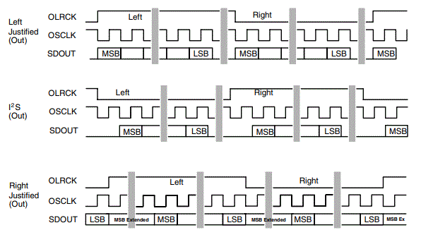

The cd drive looks like it has a s/pdif output, not i2c. I have run it to a cs8416 s/pdif receiver and it took it. I think the little board abraxalito showed me will give a s/pdif output at a reasonable rate, if I give it the timing signals that the cd drive uses. Or perhaps I misunderstand the board, as I have not looked at that part in any detail yet.
SPDIF is a one wire box to box protocol found on many cd players. The CS8416 decodes it into something useful to other chips. The philips based Arcams used I2S internally. I2C is a comms protocol.
Only if you add a SPDIF input and then you would have to configure the SPDIF receiver to meet the needs of the CD player.
You're saying my s/pdif decoder decoded I2S ?
That is what the CS8416 datasheet states. With one maybe two exceptions, digital filters and dacs won't decode SPDIF. You need the decoder to turn SPDIF into something useful to, in your case, the PMD100. The SAA7220, in earlier Arcams, would require the I2S. Even though the CD-DSP puts out the Sony format, setting the PMD100 to the LSB Justified format covers it.
Below are the formats the CS8416 can be set to.

Seems like a misunderstanding has cropped up. The old arcams had I2S. The 8SE has the Sony format. BTW, the I2S stuff is a bit of a red herring. The CS8416, like any half decent digital audio i/f chip, can be set to other formats. What make the CS8416 and the 8se an unfortunate combination for an input hack are their respective the master clock frequencies.
