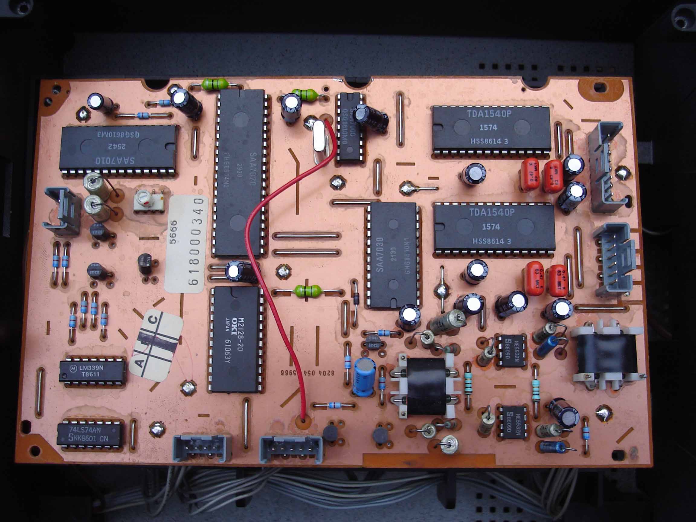

Is it possible for you to post some pictures of the decoder boards of both your CD104 and your CD7550? From the ones I already have, I can not see any differences at all – and I have worked on over a dozen CD104/204/304.

Hi Stefan, sure ... when I pull it out again to do the griplet repairs I'll take some pics.

Please find the pictures of the decoder boards as requested as attachments at the bottom of this post. I subsequently discovered that the servo board makes a difference to the overall sound too having tried swapping those. Are these setup specifically to match the units cd mechanism’s output and the decoder board and as such if exchanged are no longer matched?
Hi Ian,
Thank you for the pictures. It was exactly like I expected – no visual difference at all between both circuit boards and most of the components.

I agree, no design differences at all between the two boards. Nor is there between the servo boards either which are also interchangeable apart from having to swap the display controller chip as the displays are obviously different between the 304 and 104 units.
