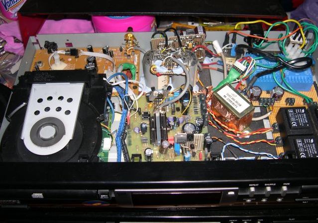

Hi Markus,
I did a different modding of the player, basically making it a different beast with TDA1541A-S2 inside, Tent master clock, synchronous reclocking, transformer I/V, etc.
But I wouldn't call that a "mod" but more a complete reconstruction (keeping the transport and control logic)
Cheers
Andrea
