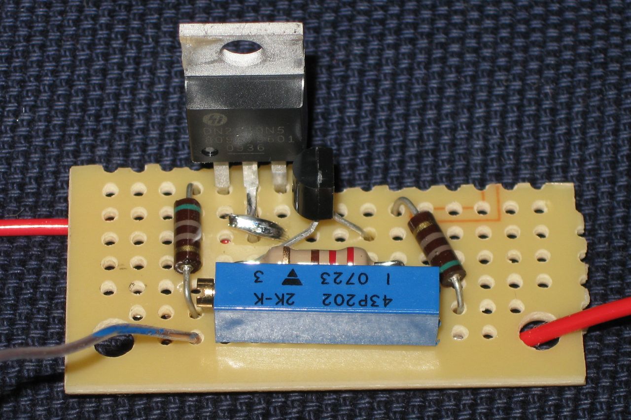

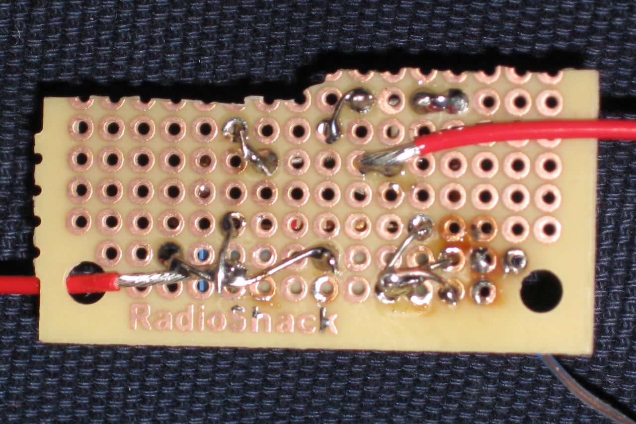

I'm struggling with the CCS's I'm trying to put on my 12B4 plates. I've got a cascaded DN2540 and DN3545 with 510r gate stoppers. The bias is a resistor and pot in parallel for adjustability. I've gone over it a bunch of times, and I'm sure it is wired correctly. I wired one into an amp, with the 12B4 pulled and a 100r resistor from the tube pin to ground. I then started bringing to voltage up with a variac (SS rectified, so I can have the voltage quite low). It seems that output current (measuring voltage across the resistor) varies with the input voltage, and it gets far too high. Also, pardon my not knowing how this stuff works, but shouldn't I measure a high resistance across the CCS? From input to output, all I measure is the bias resistance, so it seems like the Fets are shorts. It seems to me like it isn't working. I attached a pic of the CCS that isn't installed.
What am I doing/have I done wrong?

edit: why is the pot in parallel rather than series? You're going to want something like 1.7-1.9V of bias, which means that for a 20mA current (just guessing), the source R will be ~80-120R. If the pot is turned down in a parallel circuit, the CCS will run away.

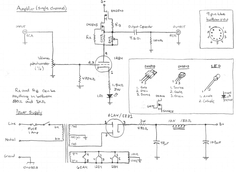

Here's the schematic from which I borrowed it. I believe it (the resistor values) is/are Bandersnatch's work, drawn by somebody over at another forum. The CCS is essentially what I've seen you draw, but with a cheaper fet in the second position and the pot for adjustability.

Lose the pot and see what happens. The current should be low (10mA or so); if it's not, you may have fried a FET. Also, the output cap should be coming off the tube plate, not off the FET source. And bleeder resistors on the power supply are a good idea if you don't want to accidentally fry yourself.
What is that output coming from top of set resistor? I have seen anti triode coming from a two resistor midpoint, but this one? An error, or some lower impedance point?
Wouldn't that be the so-called mu-output, providing a lower source impedance as seen by the next stage?
The output at the top of Rset, is a low impedance (but somewhat higher distortion) output. As SY said, if the pot in parallel with Rset is set to low resistance, current will run away.

I think I've got it working. I'm not sure what my problem was. I moved the output connection to the bottom of the resistors. Though I'll watch to see if you guys decide it was originally as drawn for a reason rather than a mistake. FWIW, I'm not using that power supply, just the CCS. The guy who drew the schematic put the LED there as an indicator, not to play a role in biasing. Now if only the switch to CCS loading and adding another LC stage to the PS had solved my problem . . . But that is a story for the original thread.

If the pot was set to near-zeros ohms when it was first turned on, the FETs are prolly toast. The circuit was originally drawn like that because I made PCBs, and the two resistors were never originally made to be both in place. Once the proper resistance was determined, the pot would be removed and the resistor of proper value would be put in place.
With no power applied, you should be able to measure across the pot and resistor and adjust to the approximately-needed-value by trimming the pot, then apply power and tweak until your desired current is met. This is actually how I've been running them, and they work fine, as long as you are careful on the first turn-on.
What is not shown on that schematic is some gate protection zeners -> two 18V zeners cathode-to-cathode from each FET gate stopper to source.
The LED and resistor was in there, simply as an indicator that the circuit was working (can put it on the top-panel or something).
I am also under the impression that the bottom-FET source will exactly track the plate, and hence have the same distortion. If the plate current is constant, then the set resistor current must be constant, and hence the voltage drop across it is constant. Hence, the mu-output is just a few constant volts above the plate, so distortion should be the same.
