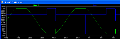

I am trying clipping for sine wave .A very slight clipping does not cause any problems. In the case of harder clipping , op amp will try to turn Q on even more , and current at base increases dramatically.Is it ok to stress op amp so , or they are rated at continous short circuit operation ?
I have attached a clipping graph and base current of one channel , with ESL load disconnected , leaving only 50pF to ground.

Resistive loads are always the best case as current is maximum when voltage across the transistor is minimum. Reactive loads can be much worse. I suggest you have a play with the free version of the simetrix simulator, which makes it easy to look at power disipation in a device.

what is that glitch in the base current as the stage comes out of negative clipping?

Thanks for your valuable reply.I looked in U and I curves for my transistor in simulator and then in datasheet.
It appears that it is within limits,except for these current spikes that occur when hard clipping.I wasn't able to avoid them , only decrese by increasing C2 and C4 ...
How to make rid of it ?
