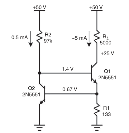

You might want to try the feedback current source in Cordell's book. It is simple and achieves a high input impedance using a pair of transistors like shown.

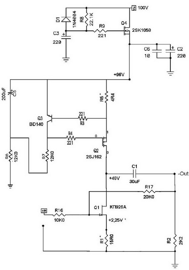

I am sorry I intended to sent this jpg . If you look at the discrete CCS in this jpg would it likely have more or less ripple rejection than a single Dn2540 at 150 ma. Oh I know a capcode Dn2540 is better than a single but that's not the question.
Woody your (Cap multiplier) plus (negative feedback Vbe/R current source) is going to have spectacularly excellent ripple rejection. If you want AWSOMELY UNBELIEVABLY spectacularly excellent ripple rejection, revise the schematic and add one more series copy of (D1 R8 Q4 C3) and accept the loss of another 4 volts of headroom, down to +92V.
But now you're in the regime where ripple rejection is set by PCB layout goodness/badness, rather than circuit topology goodness/badness
