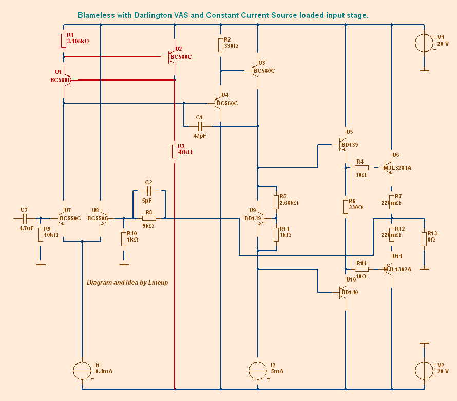

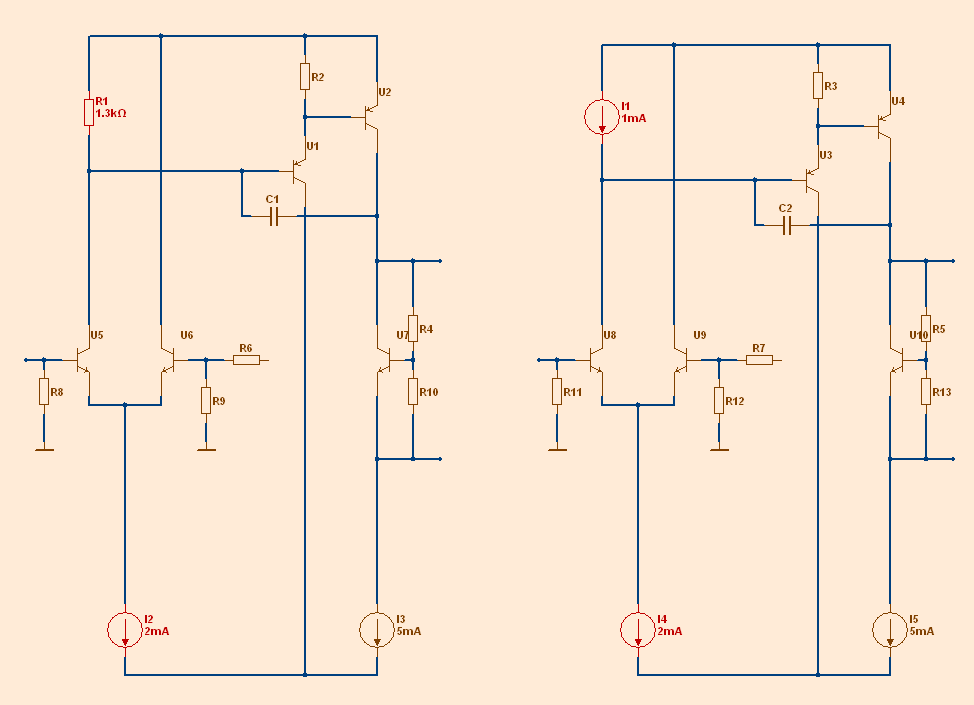

I happend to discover the great benefit of using constant current source load for input stage while I was playing with my spice models.
If you look at my first picture, amplifier to the left, you see what we can call a blameless with darlington VAS.
All very normal standard.
Resistor R1 (in red) sets 1 mA in input transistor.
At the right you see this resistor is replaced with 1 mA CCS.
This improves drastically.
When we hunt small things here and there, this fairly simple modification take us almost to another level.
At 16 Watt I could see 18 times lower THD in %.
At 1 Watt 5 times lower THD.
My second picture shows one of my amplifier models using such a current source.
It is a low power amplifier. But it is Hifi.

Problem is that the differential output can
now swing to almost 0V, that is, U4 in the right picture
can now be supplied one milliamp of base current
and with no more base voltage limitation,that was
provided by the resisive loading, thus, it will
be subject to eventual peak currents of 1mA x hfe,
about 500mA if ever the output is shorted or if the amp clip..
The standard "blameless" current mirror has this same major reduction effect on THD. It is not a "pure" CCS , but it does regulate the current , just between the pair. A THD shootout between my "BX" (simple 4 transistor input /VAS) and the "AX" blameless at 20KHZ is drastic , almost .1% for the mirrorless BX versus .001% for the mirrored "blameless".
