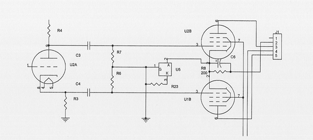

Dear All,
I am planning to mod my small pentode PP amp to use CCS(10M45, U5 in the schematic) replacing 200R resistor. Is it going to work and what kind of improvements can I expect, electronically and accoustically? The cathode current present is 72 mA at 14.3 V.
Thank you for your help.
Kay
Yes it should work. Whats R8 for ??
Understand that you are restricting the amp to pure class A operation.
I would recommend using two CCS, one for each cathode. This will make hum a thing of the past, and should improve the quality of the bass.
If you use just one CCS, people have reported improvements in definition and bass. You will want a bias balancing network to get the most benefit. ala the Simple EL84 amp on "diyparadise" (you should find a link to this in this thread).
Of course if you do decide to use two CCS, I recommend setting them up as a fully differential pair as described previously.
