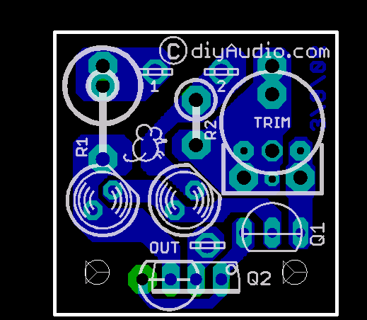

Well, this is the smallest I can get It without putting R1 and R2 upright.
(20mm x 37mm)

GeWa said:
Putting the resistors in the upright position
I did indeed suggest it to PM... if they are we do have to be careful with the sticky up ends... perhaps a bit of heatshrink would fix that if the positioning of the board might cause an accident.
We are exploring options and potential issues with those options, weighing plus & minus.
I really like how this has been going.
I am all for small, the 1 in^2 of PM's latest is real appealing -- small enuff to maybe give the option of hanging it off the tube socket.
dave
