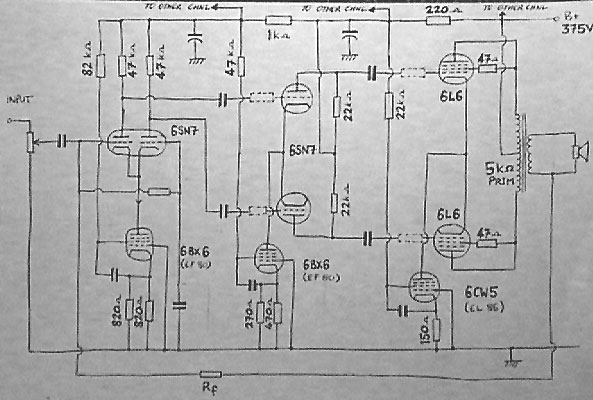

Yes, I had a good look at that schematic, and I do like it, but I'm not ready to get into negative supply rails yet.
I reckon I'll have a go with the cascode input mullard type circuit, and maybe modify it for a CCS on the diff/driver stage at a later date.
I'll use 6L6 output tubes and adjustable self bias on the 6L6's instead of the fixed bias shown. This can be modified later on too. Many people here are saying fixed bias is the only way to go really, I guess because no power is lost in the bias arrangement, and there are no bypass caps to screw up the frequency and phase behavior of the output. Is this correct?

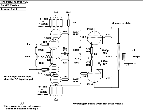

Although PP cancels even harmonic distortion at the output transformer, each individual valve distorts and produces distortion proportional to level. 2nd harmonic distortion implies a change in the DC component of the signal, and the cathode bypass capacitor integrates that change. In other words, the bias on each valve gently meanders around depending on signal level. Grid bias doesn't do that.

EC8010 has described the difference between cathode and fixed bias; especially in class AB circuits you will find that the output tube current increases as output goes up, which leads to a larger bias across a cathode resistor, decreasing the current again and limiting the output. On the other hand this is self-regulating; with fixed bias one needs to assure that things do not "run away" - that process is a little longer to describe.
But there is an intermediate way: For music output, peaks are not maintained for very long compared to the general level duration. Thus you can have almost fixed bias (or at least much of the effect) by shunting your cathode resistors with whacking big electrolytic capacitors to maintain short-term constancy - in these days of small efficient components this is a prctical alternative.

SY said:
That's a variant of the old Mullard circuit, but substituting a cascode for the input pentode.
Totally wrong, dude- the opportunity for the cascode was missed and input stage is just a common cathode triode loaded by a mediocre current source. What WERE you looking at? You're right about the phase splitter, at least.

Johan, a big bypass cap in the cathode circuit works great as long as you don't overload the amp. Unfortunately, it also slows recovery from overload. Tradeoffs, tradeoffs...
Two work-arounds that are simple would be:
put a zener across the bypass cap to limit how high it can charge
or
if you have a tube that only requires a modest bias like EL84, use a set of parallel LED strings.
Now we're cooking on gas!
Zener and big cap... elegant and simple.

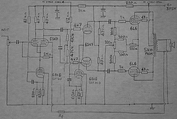

Ok,
Can anyone please tell me if I have bade any horrible mistakes with this one?
The zeners are marked 15v, but should actually be 18v, and the cap from 6SN7 grid leaks to ground should be 250v rated (not 100v as shown).
I havn't labelled the feedback resistor, as I was going to use trial and error for max output for CD input (maybe 47k as a start?)
Thanks... Bob

I don't see any serious problems, but there are more components than necessary in two areas.
The first one is rather interesting and shows the evolution of the Schmitt phase splitter. You have DC coupled the output of your input cascode to the next stage, which is great. You then looked at the other valve in the phase splitter and wondered how to bias it, so you added the usual cathode bias resistor and a pair of grid-leaks. Because the whole thing was at an elevated potential, you added a 47k resistor to ground from the bottom of the cathode bias resistor.
It will work, but you don't need such complexity. The valve that you have DC coupled to the input stage has a DC path to ground from its grid (the anode load of the previous stage), and its cathode potential will be almost equal to its grid potential. Since we can see a large resistance to ground (1k + 47k), that will define the current through this valve. We can remove the connection between the two grid-leaks and the junction of the 1k and 47k. We now see that we have a pair of 1M resistors in series, so we can combine them into a single 2M (or 2M2) resistor, and 47k plus 1k is near enough 47k, so let's throw the 1k away. Will it work? Yes, the second valve has the same DC path to ground as the first, so any changes in the DC potential of the cascode will be tracked by both valves and rejected by differential action. That's great. At audio frequencies, the 1uF capacitor is a short circuit to ground, so the stage amplifies audio frequencies. You now have a Schmitt phase-splitter. Depending on the LF stability once global feedback has been applied to the amplifier, you might not need quite such a large capacitor as 1uF.
And talking of global feedback, you have applied it to the cathode of the input stage in the traditional way with a 100R resistor down to ground but have omitted the capacitor across the upper resistor to the cathode. If you applied the feedback directly to the cathode, you can drop the 100R resistor. Calculating the value of the feedback resistor becomes much harder, so you might prefer to just go for a suck it and see approach of putting a variable resistor in and adjusting it on the bench for the required gain.
Go ahead and build!
Thanks for checking it out. The changes you suggested have been made (although the values you mentioned were not as labelled, but that was probably the crummy picture I posted).

Just a little bit from me. EC8010 outlined the Schmitt design admirably. As I calculate the voltages shown should be reached. Only one thing here, the "bottom" capacitor from the (new) 2.2M to common can be much smaller (as EC8010 suggested). In fact, 10nF would already get your loop response as low as about 15Hz. You do not give the driver coupling capacitors; I would make these quite large, like 220nF or so. The point being that should you run into any low frequency instability with feedback (motorboating), you get rid of that by shifting the former mentioned pole higher (making that 2.2M series capacitor smaller). That way you avoid having large amplitudes on the drivers. Not knowing the inductance of the output transformer one can make no suggestions at this stage.
The zeners are OK, but........ The cathode voltage for 6L6s under 450V is rather around 37V instead of 16V! (That should give 65 mA anode current or about 27W dissipation. OK, a 6L6GC is allowed 34W in triode mode, but I do not trust many of the new 6L6s; rather stop a bit lower.) If you use zeners as the main cathode "resistors" you also no longer need the resistors or even separate zeners for 2 tubes - you should now balance for anode current in a different way. But the dissipation goes high; 5W for a single zener source.
This is obtainable, but here one should note the zener's temperature co-efficient. (At 35V they are more avalanche than zener.) It is thus advisable to make this up from a chain of lower values. Round about 6V will give a zero temperature co-efficient. May I suggest 3 x 5.6V zeners plus 3 x 6.8V zeners, which will bring you close to the desired value. You can now use 1W zeners or for safety perhaps the next value, which over here is only 5W, but they only cost (here) about 50c (USA) each. You could retain a bypass capacitor.
As SY suggested this is a handy source of fixed bias, but zeners are noisy. I have used this once some years ago, and as I can recall I had no addition of noise at this signal level. But perhaps others with more recent experience here can enlighten us.

I've changed the ground reference cap under the driver grids as you recommended, and I've re biased the outputs using 2x390 ohms. According to the 6L6G curves for triode, with 450v and 5k output (2k5 loadline) this should give me around 23v on the Cathodes, and around 60mA through each tube.
I'll play with the bias once I get a working circuit together, maybe starting with 470 ohms or something and looking at voltages.
It never occurred to me to use zeners alone for bias, but it makes sense.
