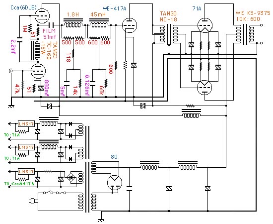

I tried this in a preamp linestage and in the input stage of a power amp back in the late '70s (inspired by Ike Eisenson), using 12AX7s and FET current source diodes. It worked, but didn't really get me any performance advantage in exchange for the complication. Haven't bothered since then.

If you include the Bottlehead Foreplay with "Anticipation" C4S upgrade(CCS loaded VA stage direct coupled to CCS(ink) CF, then yes, hundreds of times.
