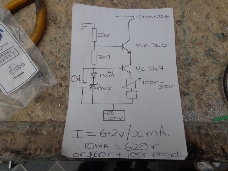

Attached is a CCS I use in all my amps. I use a zener rather than an LED as it has a higher voltage meaning you have potentially more adjustment range. I usually use a 6V2 zener, to work out the emitter resistor divide 5.4v (6V2 minus 0.6v typical Vbe) by the current you want. In the attached I needed 620r so used a 560r fixed R and a 100r Piher preset. I tend to use 500r Piher presets at present usually centered at 250r.
If the wiper lifting worries you use a 500r preset with two 1k fixed R's in parallel across the preset. If the wiper lifts the CCS current will be reduced. A simpler CCS also attached. MJE340's are traditionally used but a BD139 works ok too.
Andy.

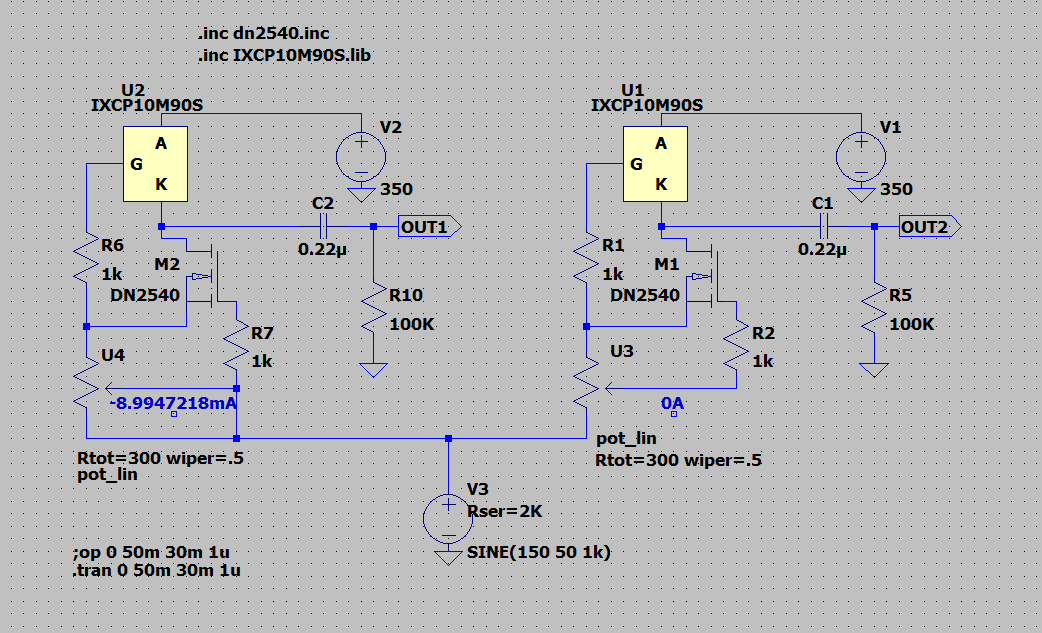

I'm always afraid of using small trimmers where a significant current will flow through the wiper. Will the following approach (U1 section) be fine for biasing a CCS using a pot? The extra resulting resistor in the current path is small enough to not affect the CCS, I believe. Any drawback of this approach?
Thank you!
Jose
If this is a set-it-once design, I'd use the trimmer pot to find the optimal setpoint for the circuit, remove the pot, measure its DCR, and then used a fixed resistor of that value. Kluge up a series/parallel combo if necessary to achieve the desired value, since chances are high that the setting will not conveniently fall on a standard one.
