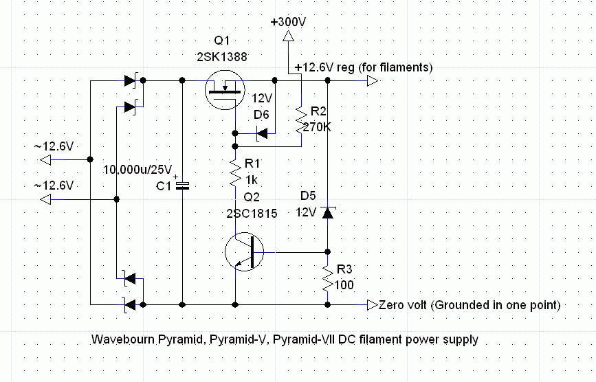

I need to create filament supplies for my indirectly heater triode signal tubes. One friend says Constant Current is the way to go while another insists that Shunt is better.
What do the filament experts here think? Much appreciated. I don't have a lot of experience with different filament methods. I usually just build the standard regulated supply.

Once more:
enjoy!
Shunt regulation on tube heaters is a desaster in terms of efficiency. Shunt regs are said to be really good if they draw at least twice the power needed by the load, so this is becoming a rather hot deal.
Contant current is fine, as it avoids the turn on current surge due to the cold filament wires. Your tubes will perhaps be thankful in terms of life span.
Thanks Wavebourn! I didn't know that. I have a small question on your schematic but I want to study it before asking.

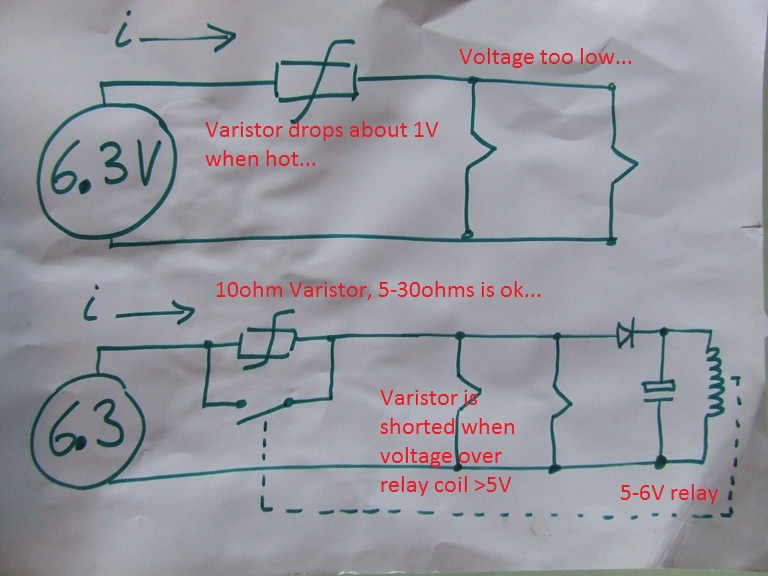

For subduing inrush current on cold heaters, if you want, this simple semi-passive circuit does a good job: (Yeah I like this circuit) 🙄
The cap is there to provide a relatively smooth DC for the relay, but untill the voltage is > coil rating, the relay starts to click as the voltage rises. Gives a nice indication the circuit is getting ready...

Oddly enough, I had to do that for my tubescope supply. The CRT heater, HV and PWM controller supply are created by a self-excited oscillator, which starts with fairly low bias (fractional mA). If the load is light, it will easily start oscillating, supply voltages rise and the regulator comes online (increasing bias as required). But when it's shunted by a cold heater, it takes a very long time to start up. At cold temperatures and low line voltages, it may never start! So I added a small NTC in series with the heater winding, and now it starts up immediately.
An unusual circumstance, but it will work just as well for other situations. Note that you need a fairly low resistance NTC, because you want a lower quiescent voltage drop than an offline supply requires. A few volts out of 120 or 240V isn't a big deal, but out of 6.3VAC, it is!
It's not all bad, of course; most of the time, the heater winding is over spec anyway (~7.3VAC?), given modern line voltages. A little drop would be quite healthy for the tubes.
