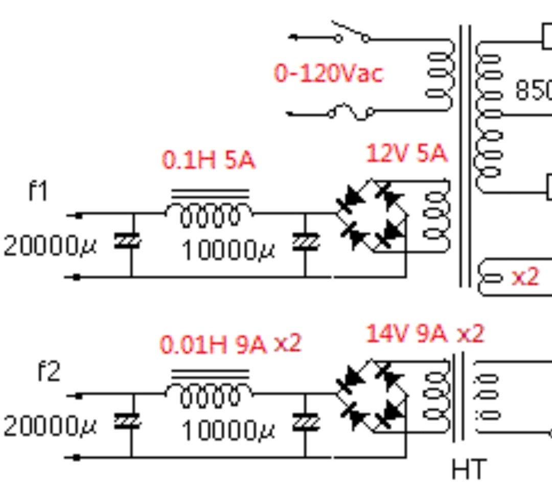

Hi, in Sakuma tube amps, there is a lot of examples of simples diodes + CLC or CRCRC (bigs C) CC filaments supply. Even in DHT tubes. Is this CC filament supply type a good performer?
