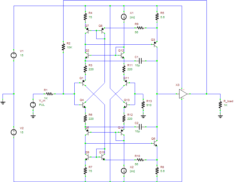

Back in summer 2009 I designed and simulated a couple of circuits based on the "Rush Cascode" as an input stage. I then promptly forgot all about it. Recently I came across the old schematics again and thought it would be a good idea to actually build them on the breadboard, so I did.
I have attached the schematic of the last circuit I tested. You can see the others and the results on my website.
