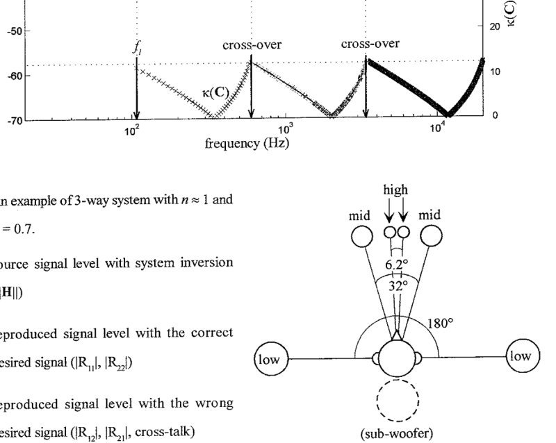

As promised, here's one of the Opsodis papers. No offense to the Opsodis folks, but all of their papers seem to omit the psychoacoustics behind how the tech works. Their papers seems laser focused on technology designed to improve the dynamics of speakers using crosstalk technology.
But their papers don't actually get into the crosstalk cancellation technology itself, and why it works even with the drives spaced at ridiculous gaps (as in Opsodis.)

The paper that set me off on this journey, came to a fairly extreme conclusion: one may be able to have a stereo soundstage with a mono tweeter.
This sounds like a ludicrous claim on it's surface. Because something I've noticed that people do in car audio, is that they tend to put their tweeters as wide as possible.
IE, if we could get a stereo soundstage with just one tweeter, then why would people be naturally inclined to locating their tweeters as wide as possible?
So let's look into this:
10khz is 3.4cm long (1.35")
That's well out of the range of sounds where phase is important. If you move a tweeter by a distance of one centimeter, nobody is going to perceive a difference in location. But if you lower the level by 3dB, they will definitely hear that.
This next part is super important, and accentuates why a mono tweeter(!) may be acceptable or even superior:
While you will not be able to perceive a difference in location if you move your left speaker by 1.35", there WILL be a measurable difference in the amplitude of the stereo speakers. For instance, if get your left and right speaker perfectly in phase, if you then move the speaker (or your head!) by 1.35", there will be some left-to-right cancellation at very high frequencies. This is because the wavelengths are so short.
It's a catch 22:
1) In order to perceive location at high frequencies, we depend on amplitude differences
2) But a path difference of as little as 1.35" will wreak havoc on the overall high frequency response!
Anyone's who's measured a set of speakers playing in stereo knows exactly what I'm describing; the interference between the two creates a myriad of comb filters, and especially at high frequencies, the two speakers tend to cancel each other out because of this.
Looking at everything holistically, it becomes apparent that:
1) a narrow spacing between tweeters is not only acceptable, it's likely preferable. And taken to the extreme, one might play very high frequencies in mono with a single tweeter placed in the center.
2) As frequencies get lower and lower, phase becomes the most important. IMHO, phase is much harder to "fake" then amplitude. With amplitude differences, we can fairly easily compensate by adjusting that amplitude. Phase is way trickier; while we can manipulate phase to change the location of sound BETWEEN two stereo speakers, it's very very hard to make it sound like the sound extends BEYOND those two speaker locations.
IE, if I have two speakers placed two meters apart, I can manipulate the phase to make the sound appear to be radiating from almost any point between the two speakers. But I can't easily or reliably make the sound like it's coming from beyond the confines of the two speakers. This fact encourages me to place the speakers as widely as possible, to achieve a wide stage. But the wider you place the speakers, the more you get a "hole" in the middle of the soundstage.
Although it's (strangely) ignored in the patents and the Opsodis docs, the Opsodis locations largely solve this issue with stereo playback. At low frequencies, the drivers are placed extremely wide. That establishes the width of the stage (huge.) As we get higher in frequency, the playback devices span a much more limited width. It's not in any of the Opsodis patents, but an obvious possibility would be to make the very high frequencies play back in mono.

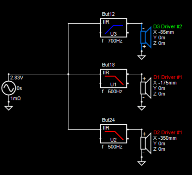

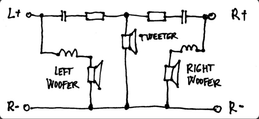

Here's my basic idea:
1) The fundamental challenge with CBTs is that even the best implementations have terrible response at high frequencies (see attached)
2) The obvious solution is to add an array of tweeters. But that gets messy and expensive and time consuming FAST because you may need as many as 50+ tweeters per side. You can't use a single tweeter because the vertical beamwidth is all wrong.
3) But the OPSODIS concept basically takes a three way speaker and separates the elements horizontally. By doing so, it might be possible to get a convincing/coherent soundstage, even if the various frequency ranges are on different horizontal planes. Pathlength is the key here; though they're not located on the same vertical line, their wavelengths arrive in-phase because they form an arc around the listener.
Or at least that's the idea.

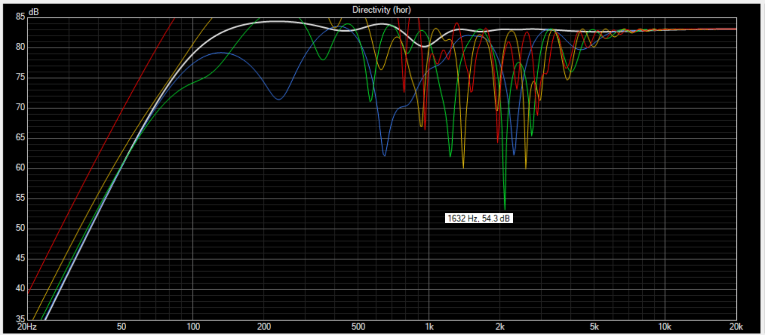

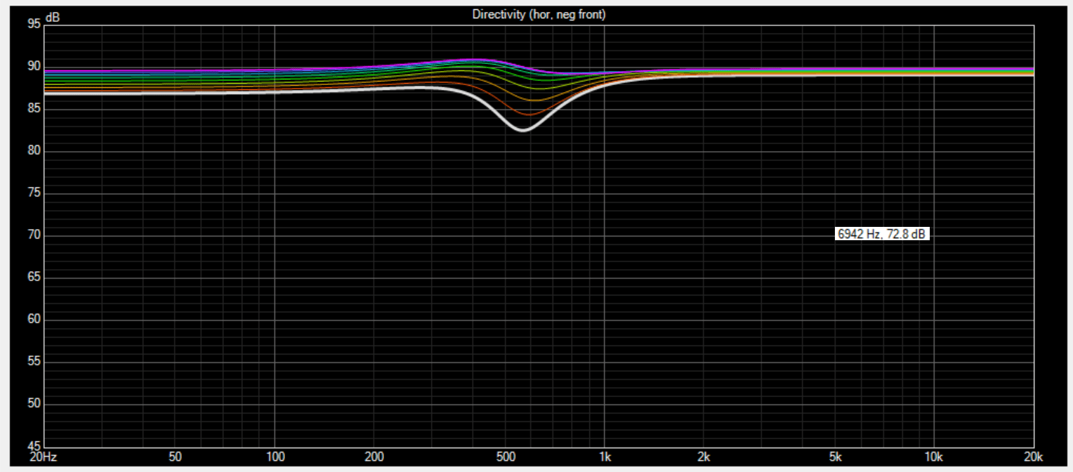

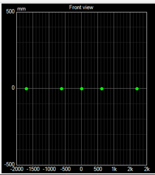

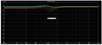

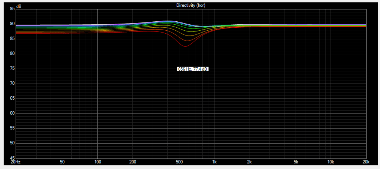

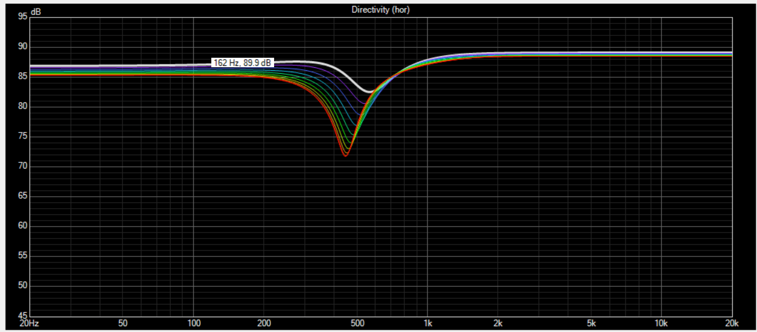

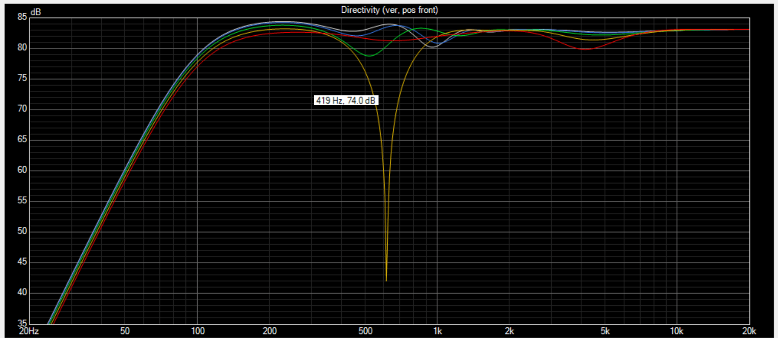

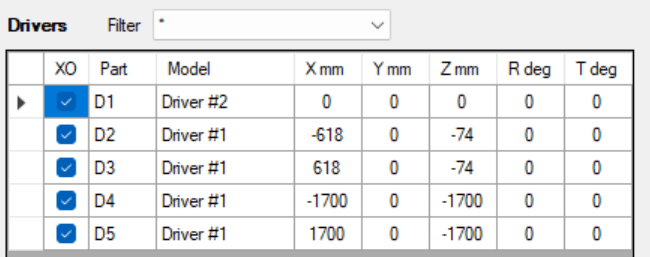

I spent way too much time doing sims in VituixCad, and came to realize that the entire Opsodis concept probably requires the listener to be quite close to the loudspeakers, much closer than in a conventional two way setup.

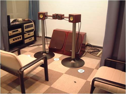

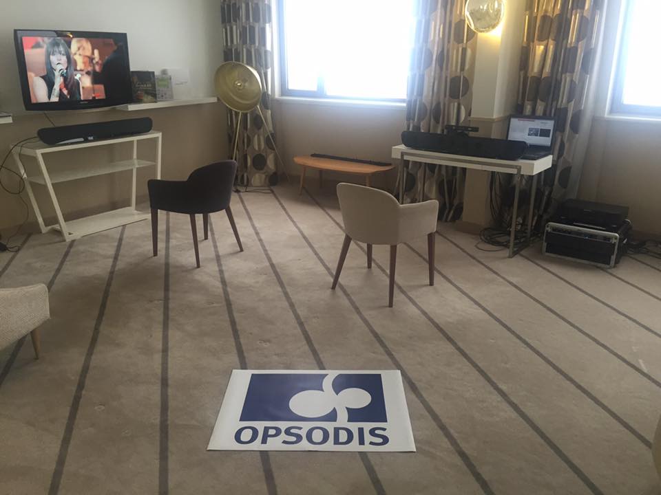

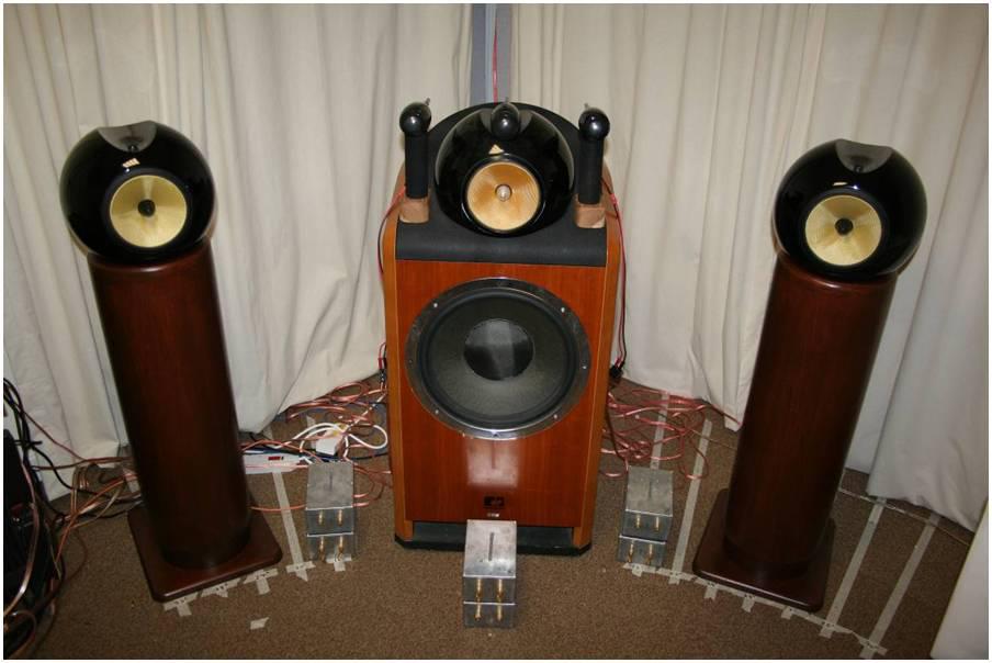

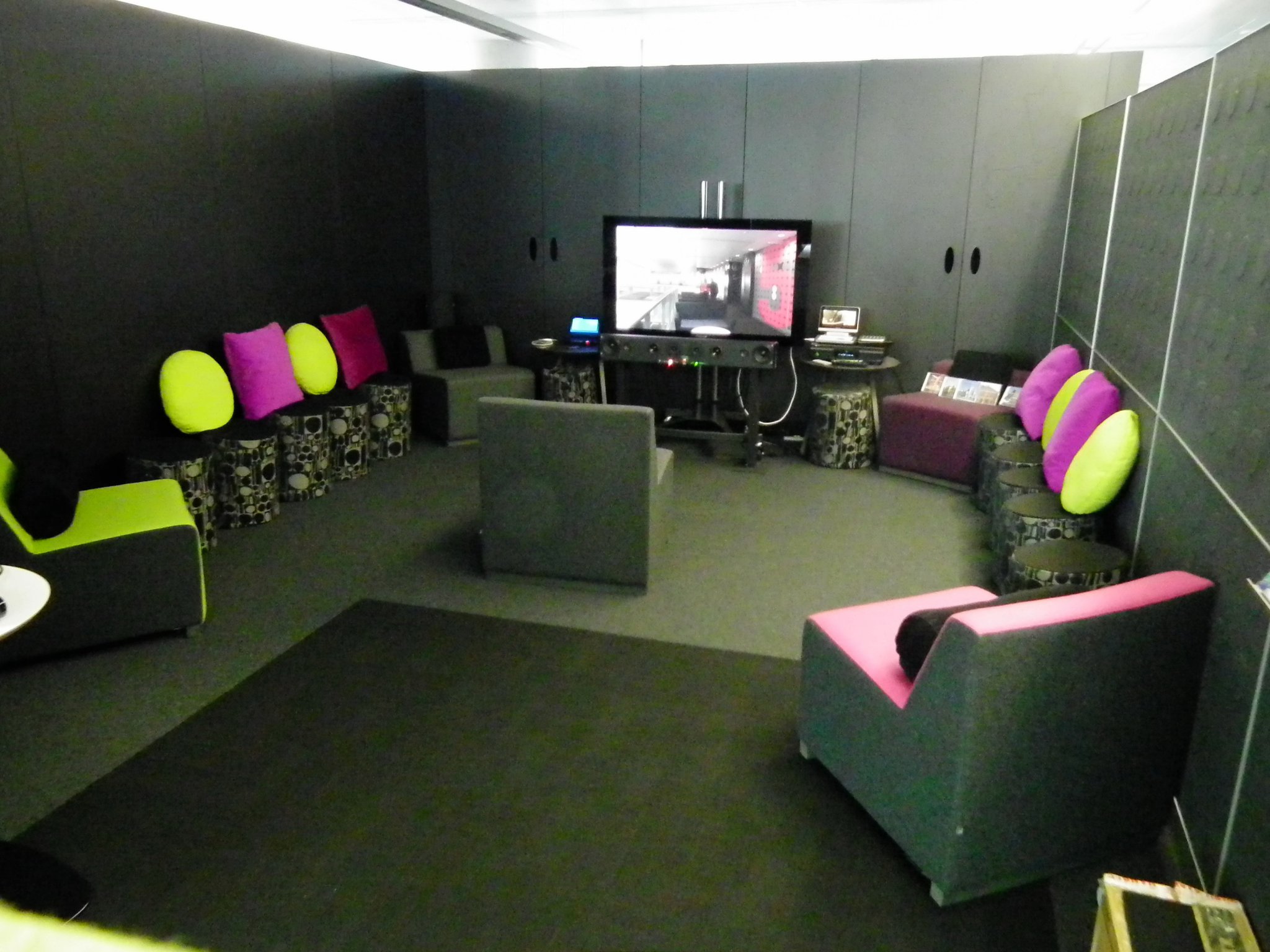

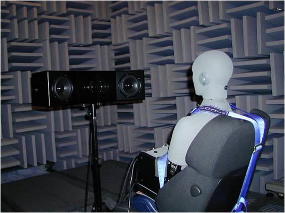

Attached are some pics of Opsodis setups from the Opsodis folks themselves. In my next post I'll elaborate on why you probably want to be much closer to the speakers in an Opsodis setup, compared to a conventional setup.

Why could we just use two tweeters set up like this and cross it at 3000hz use two 8ohm tweeters bridge off the cross over to two 4 ohm midrange in the kicks and aim each tweeter to both seats won't this work with each seat receiving a mono signal with combined l+r to the driver and the passenger with mids in the kicks or is it wishful thinking

In post eleven, on this page, I noted that Opsodis seems to be best when listened at close range.
Here's some sims to illustrate what I mean.
Basically I set the 'ring' of speakers up, Opsodis style, in VituixCad. What I found:
1) Even with active filters, I had to tweak the distance from the listener to the speaker, on a driver by driver basis
2) When you move to the left or to the right, even an inch or two, the response goes to hell.
What's happening here, obviously, is that the largest distance from driver to driver is making the array extremely sensitive to small shifts in the listeners location.
When I'd messed with Opsodis in the past, I'd done so in a car, and I also did something a bit like it on a desktop setup I had about seven years ago. But in that setup, the left and the right speakers were less than a meter from me. In my current office, that distance is more than double.
I'm not ready to give up on this, because I've tried it before, and having the speakers in a semi-circle sounds great. What I'm thinking right now is that it might be better to have the left and right speaker in their 'normal' locations (stereo triangle) and then add some midbasses to widen the stage. This would be a bit like what Geddes does with subwoofers, but instead of distributing the subs in the room, I would be overlapping a pair of midbasses on each side. This accomplishes a few things:
1) It should widen the stage. The fundamental challenge with midbass is that you can't really 'fake' where it's coming from, so if you want to widen the stage, you need to literally widen the speakers. But you CAN fake where high frequencies come from, to an extent. (See first post in thread.)
2) It should smooth out the in-room response, since the midbass is distributed. 340Hz is a meter long.
3) If I want to get really fancy, I could put the mids in an end fire or a gradient array, to reduce radiation hitting the back wall.

Just to elaborate on what I wrote in post fifteen:
1) in the first attached photo, you can see that if you're even ten degrees off axis, the response just goes nuts. It's nearly unlistenable if you move your head a few inches.
2) But the vertical response is still pretty good. This is because this is basically a conventional array that's been flipped 90 degrees. So instead of being insensitive to where you are horizontally, it's insensitive to where you are vertically.
I created an end-fire array, using passive components.
In a conventional end-fire array, the delays are achieved using DSP delay: https://www.prosoundweb.com/the-end-fire-cardioid-subwoofer-array-made-visible/
But you can do an end fire array without DSP delay, by using increasingly higher order low pass filters. JBL does this with their CBT arrays: https://www.diyaudio.com/community/threads/passive-loudspeaker-delay.280664/post-4473934
Attached is the response of three woofers, with the bottom two low passed. The low pass filter achieves the delay required of an end fire array. The response is shows from the RIGHT of the speaker, like this:
The second set of attached images are the same sim, but measured from the FRONT of the same array. IE, how you would listen to it in the real world. The first is in front of the array (no need for a second image, because the response is symmetrical) and the second is the VituixCad model.
Yes it is theoretically best for crosstalk cancelation. OSD optimal source distribution it is called in some papers. But widely spaced speakers are the second best option. Because head shadowing at high frequencies does quite high cancelation naturally. DSP crosstalk filters should include generic head shadowing filter to work well. Expecially for wider angle.I don’t know any plugin with this. Tried some of them and agree that they sound wrong.basically takes a three way speaker and separates the elements horizontally
