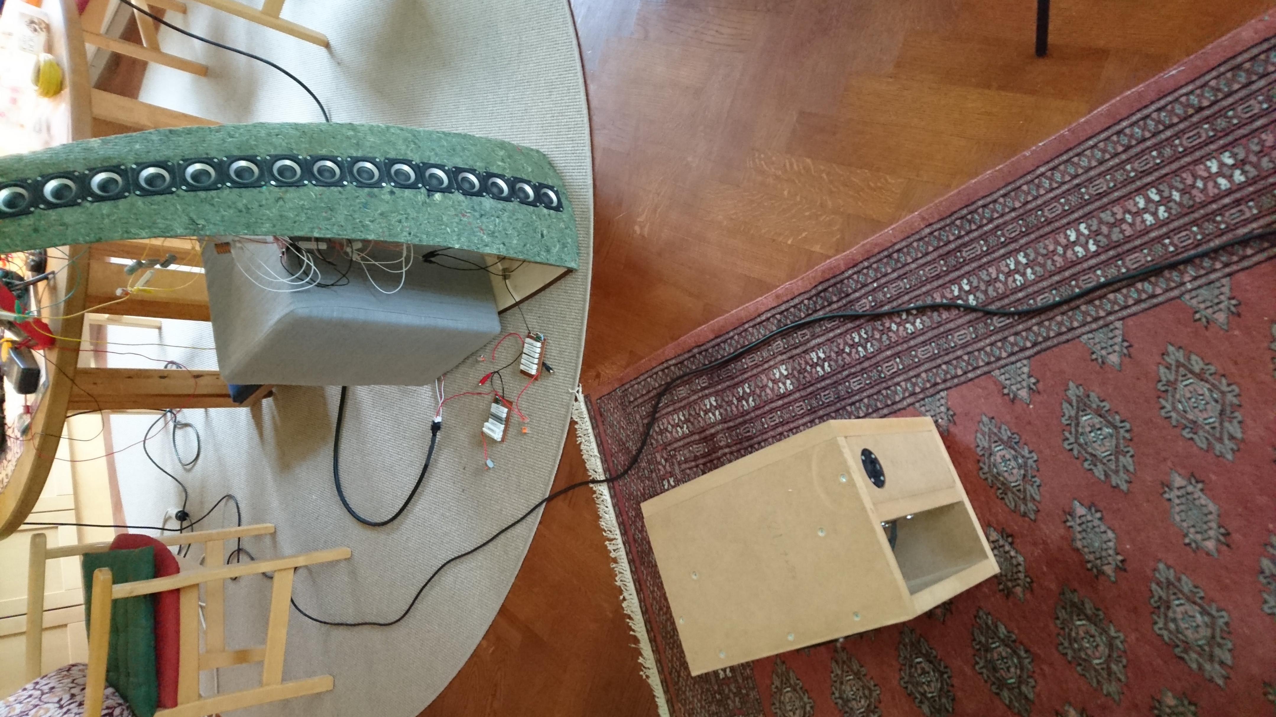

I've fallen into the rabbit hole of building an array of SB65WBAC25-4 drivers.
My current main speker is a 3-way and the response differs a lot when not in the sweet spot. CBTs seem to perform well here but I like dipoles hence a dipole CBT.
I've based the speaker on the following papers by Keele:
http://faculty.tru.ca/rtaylor/publications/cbt_dipole.pdf
http://faculty.tru.ca/rtaylor/publications/dipole_cbt_implementation.pdf
I want to try a CBT-shaded 70 degree circular arc dipole with 22 drivers in each speaker. My experiments so far have shown promise.
The first image is the first prototype. When taking the photo I was comparing having half drivers inverted vs all same direction. All same direction outwards measured far better. The prototype has 4 banks, which I realized with 1 resistor and 3 channels.

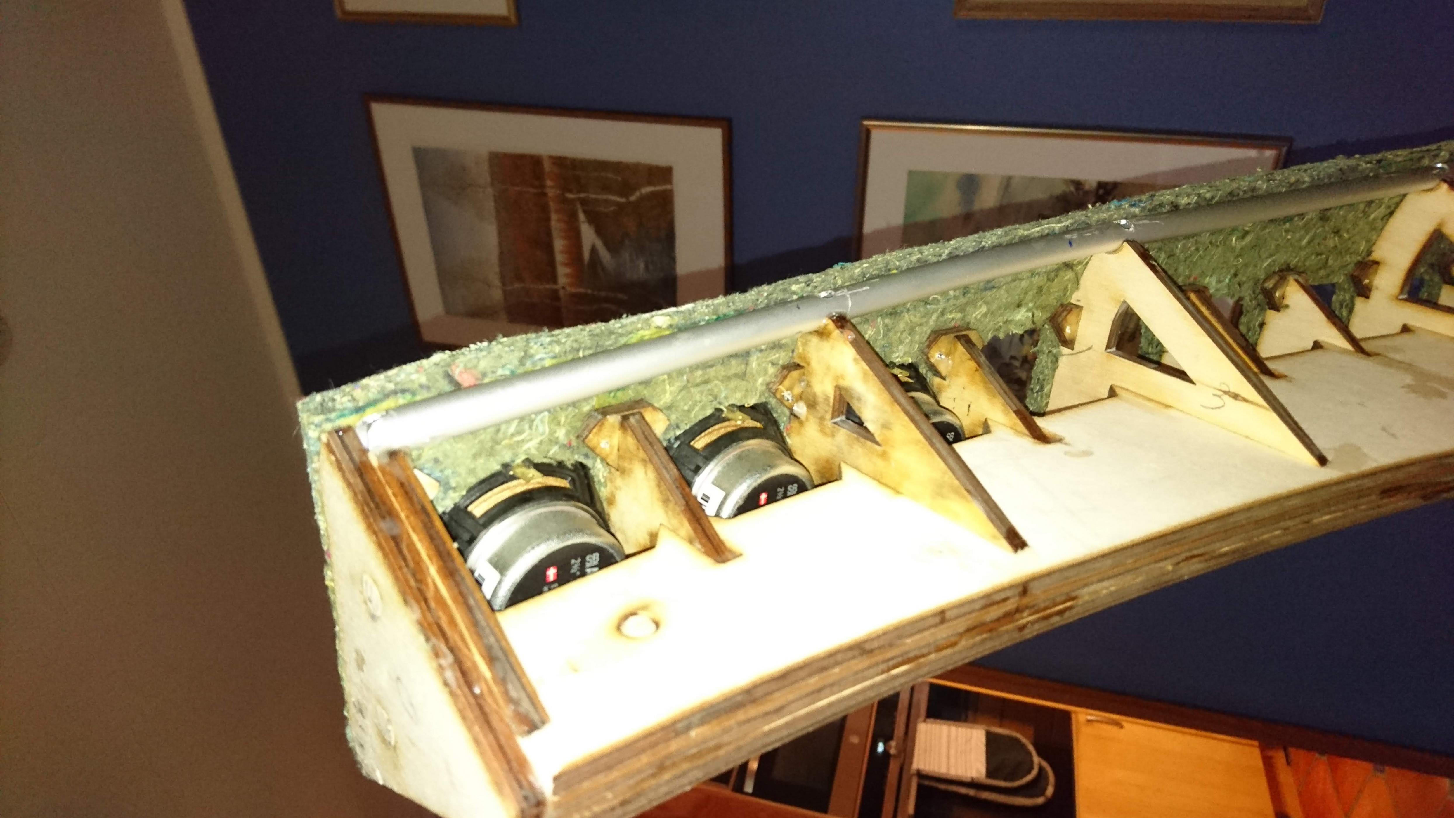

The next step is to build the real ersion, I just got my package of laser cut plywood =)
Along the outer spine edges I'll glue a 10mm round alu tube bent to match the speaker and then cover the whole front with a layer or more of wool felt. Should give me at least 6 dB more efficiency on the low end. (I got 10 dB with only 4 drivers). And to make it look nice I want to try and see if I can taper the baffle width. In theory it will counterract the issue that around fs the driver impedance peak will overpower the crossover. The width of the baffle around each driver is proportionally same as the attenuation: half width equals half voltage.
The final speaker / next prototype will have, well, 9 banks of attenuation. I want to keep the attenuation at high fequencies so I've planned to add inductors to the 10 ohm resistors.
The attenuation is cosine shading like they used in implementation in the paper. I made a spreadsheet to calculate the attenuation for each driver: CBT shading - Google Sheets
Because I know nothing of CAD I wrote a python script that outputs a bitmap of all the parts, then I loaded it into Inkscape and converted it into lines. If anyone wants it I can share the code but beware, it is kinda ugly ;)

Kudos to your efforts to construct a dipole CBT. I had a look, thanks to Don Keele, at the 2017 papers coauthored by Don and the Canadian researchers. I proceeded with my Modified CBT24 project because I wished to have a shorter path to a living room speaker versus working via the dipole route.
You likely will need both dipole subwoofers and midranges to cover the low end of the frequency band as open back SB65s will not cover much into the lower 100s Hz area. I'll be interested in your progress.

I've played around with Linkwitz SPL_MAX spreadsheet and while it is not quite an apples to apples comparison I lowered to 16 drivers due to the shading and set the baffle width. In that projection I should hit xmax at around 100 dB @ 140 hz which should be plenty given a crossover somewhere in the 120 hz - 200 hz range.
The project for next weekend is to try it in practice with the wool baffle and all. I have a pair of W-frame dipole woofers and ideally I want to keep it a 2-way. The plan is to place them just behind the speaker on top of the base.
The big question is how far down they will perform well, can I push them down to 140 hz? Will the woofer integrate well at 140? My preliminary measurements have shown that I can push the woofer crossover up to 200 hz and still have a decent result but lower is probably better.
I doubt that pushing the open back SB65s into the 140 Hz region is in your future unless you aggressively equalize. Working with a sealed box SB65 in my Modified CBT24 the 3 dB down value frequency is 140 Hz. I crossed the CBT arrays to the sealed box woofers at 125 Hz with modest EQ.
I have never built a W-frame dipole woofer but I have built H-frame dipole woofers which could be used to 200 Hz. Perhaps you will have good luck with your open back SB65s but 200 Hz would be a good goal for your merge.
Good luck!

Yup, I'm not yet convinced it will play nice below 200 hz. In theory the normal 6 dB rolloff / oct should become a 3 dB due to it being a shaded CBT. At least down to ~ 120 hz. And on top of that the wool baffle should increase efficiency by quite a bit. In a normal non-cbt configuration I increased the low end efficiency by 10 dB with a ~ 30 cm wide wool baffle. Reality, however, has a nice way of demolishing nice theories :D
I have tried to cross to one of the subs placed behind at 200 hz and while higher than ideal it does work without major issues. If that doesn't work either then I'll have to go multiway. Or probably first try to redesign the sub to work with a higher crossover.
The plan for this weekend is to build it and measure the distortion. Then we'll see how it actually performs and what it can do.

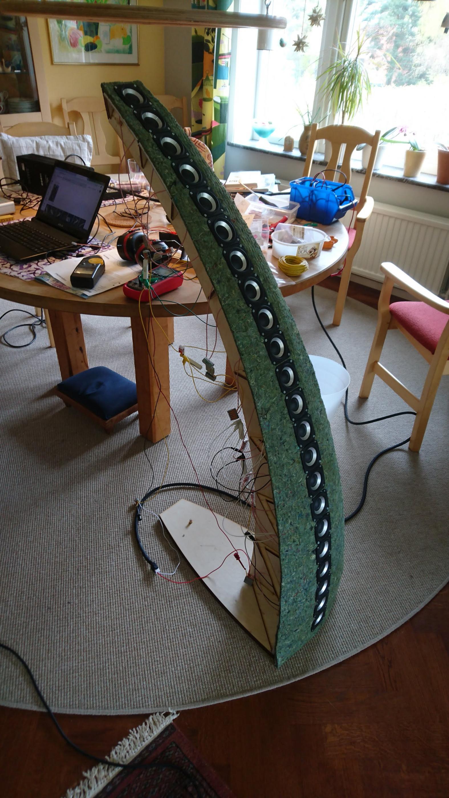

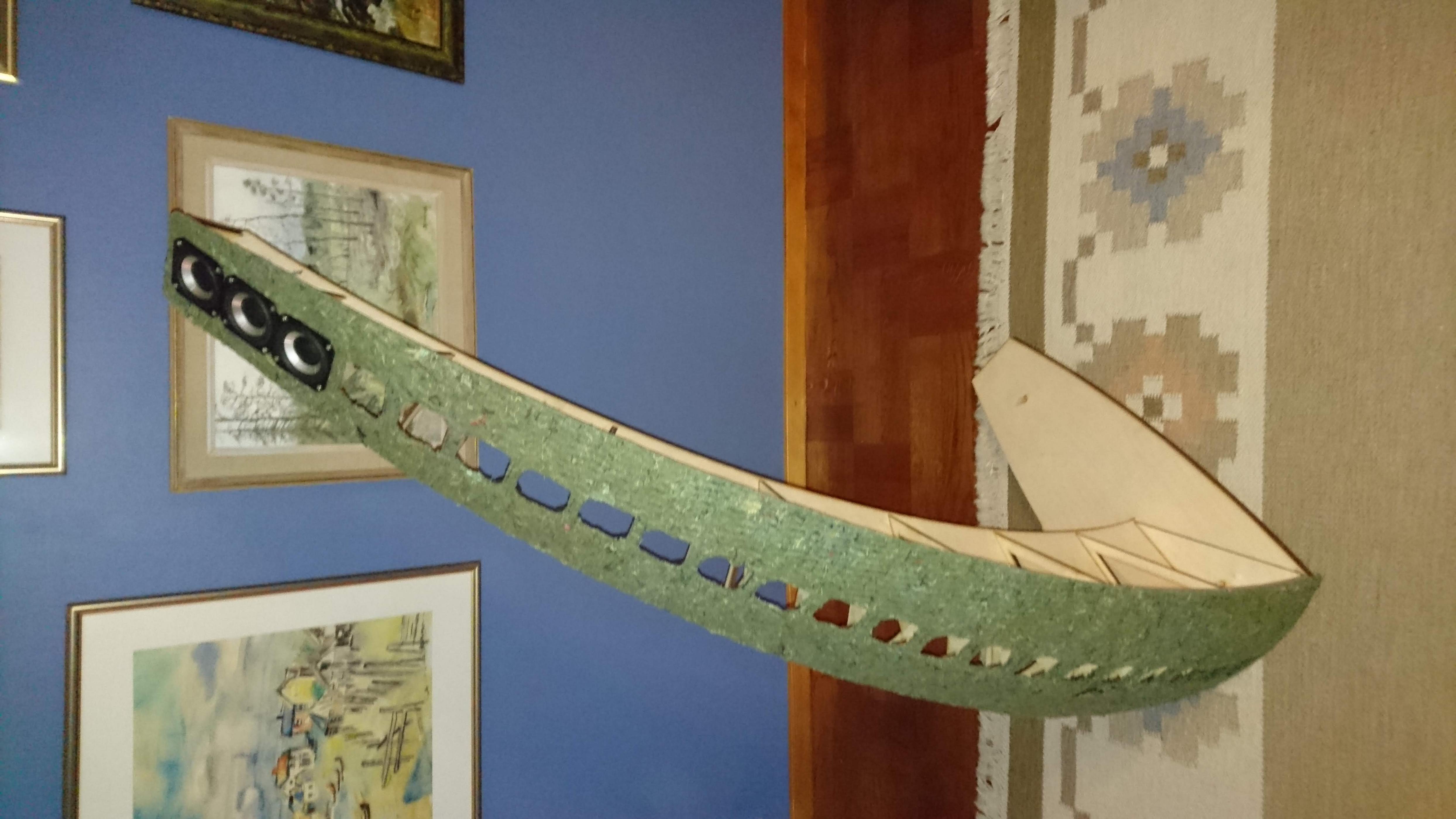

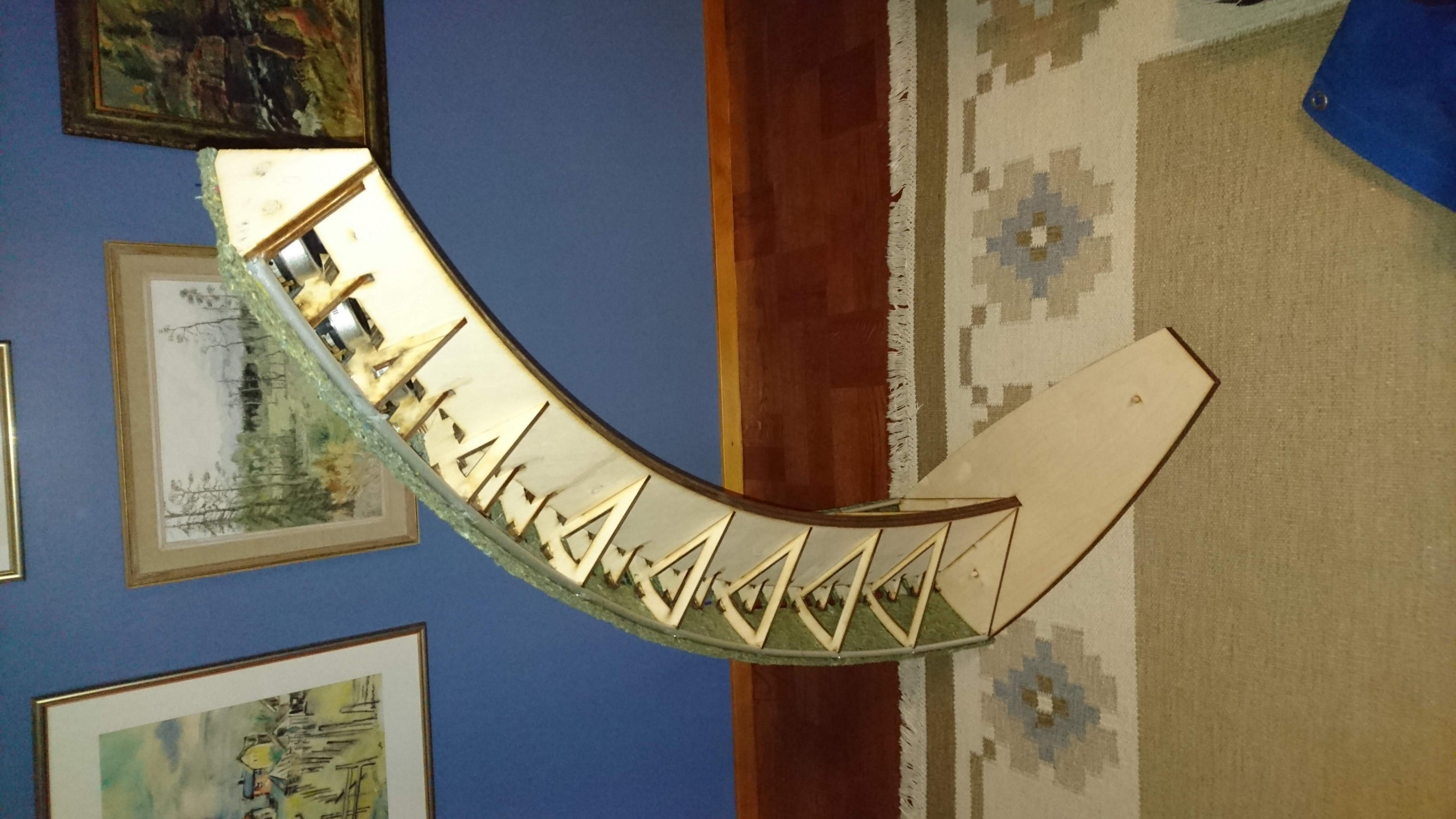

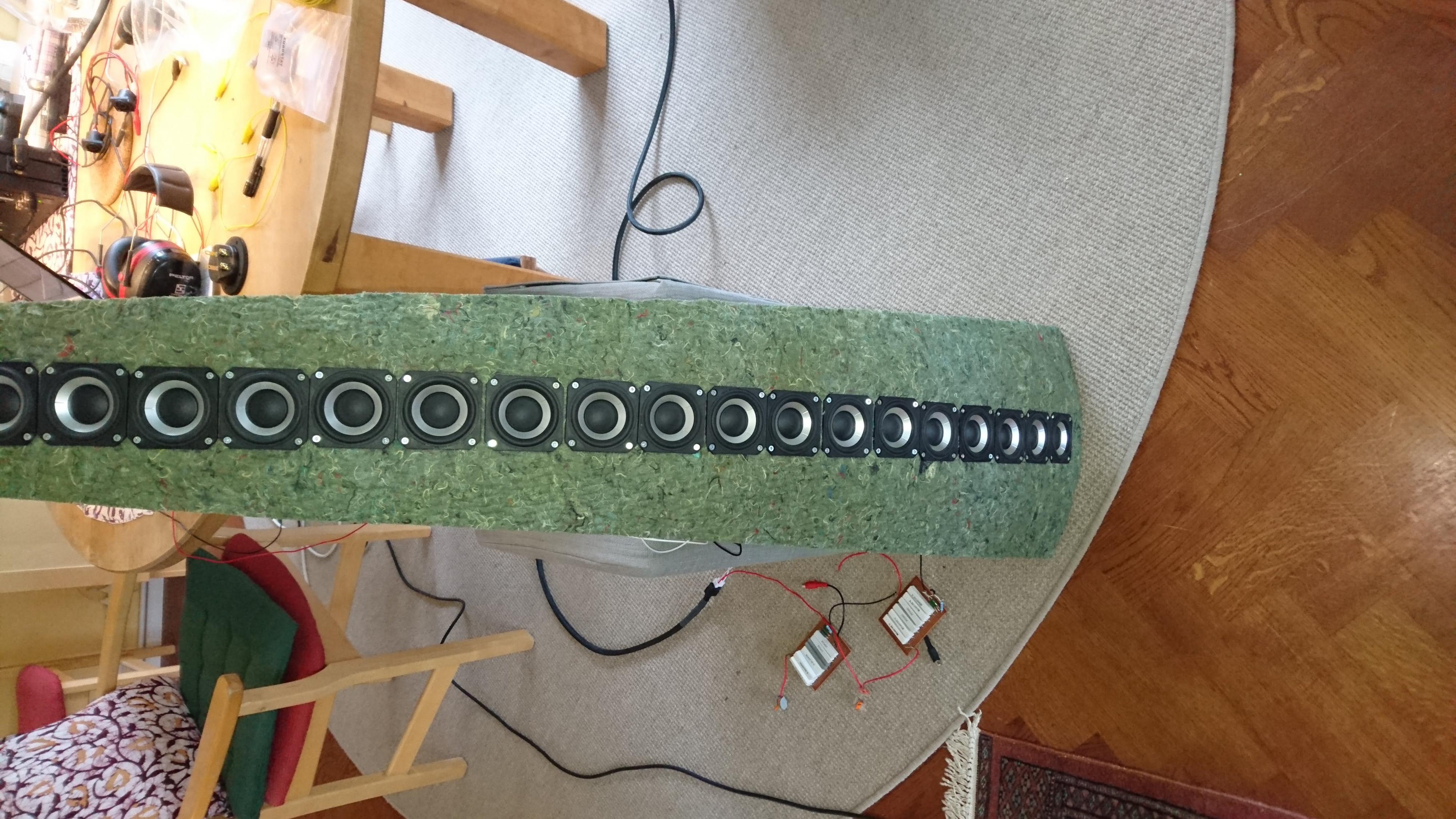

Sadly I did not get far enough to get to measure distortion. I did get some progress though and I like the look of it so far.
Next step is to mount all the drivers, connect the shading and then it is time to measure distortion =)

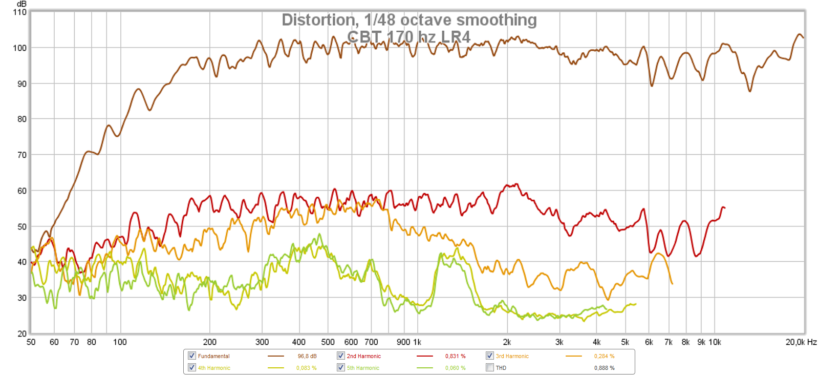

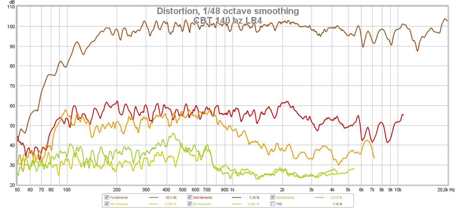

We have measurements!
This is indoors @ 100 dB @ 1m distance @ 1m height.
Apart from a DSP 18 dB highpass at 140 / 170 hz there is no EQ applied. And if it performs like this it's not like much more will be needed.
And based on the measurements crossing at either 140 or 170 hz is no problem at all. Although 170 hz is probably a little better as we cut off that slightly rising distortion as long as I can combine it with the sub without issues.

Wow, no dipole peak to take care off. Very nice! I hope to get good results with your felt technique on my dipole experiment.
Yup, wool takes care of the dipole peaks. At least in the current setup. If front-back dispersion is "too good" then a wider wool baffle still gets the dipole peak problem, say if you use a neo8 / neo3 then a baffle wider than a few cm more than the drivers start to hurt more than they help.
Since the speaker works great the next step is to add the subs, and they do not look nice when placed behind the speaker :D
In the photos I have flipped the sub because if I had it the normal orientation it was 45 cm wide and looked huuge. Not that visually appealing. Right now it is still 33 cm wide which looks a bit... ugly.
The current idea is to abandon the W-frame design and use a N-frame (like the smaller one in the image) but stack 2 on top of each other. The force cancellation won't be as good but then I can reduce the width to 22 cm. That should make it more stealthy and to make it look more nice I'll test adding curves and roundings all over so it isn't as square and sharp. Will probably fit in better with the smooth curves of the main speaker =)
