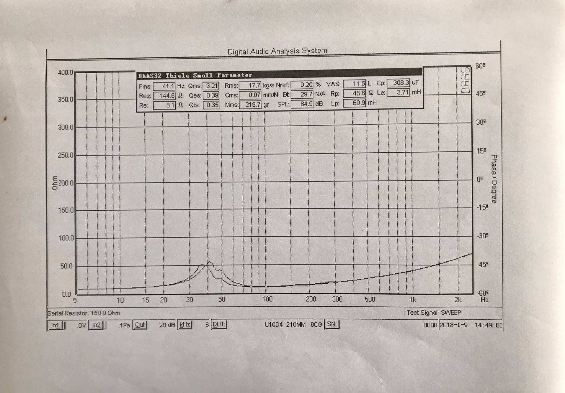

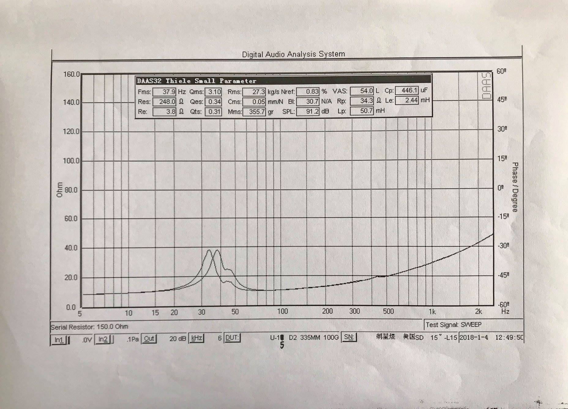

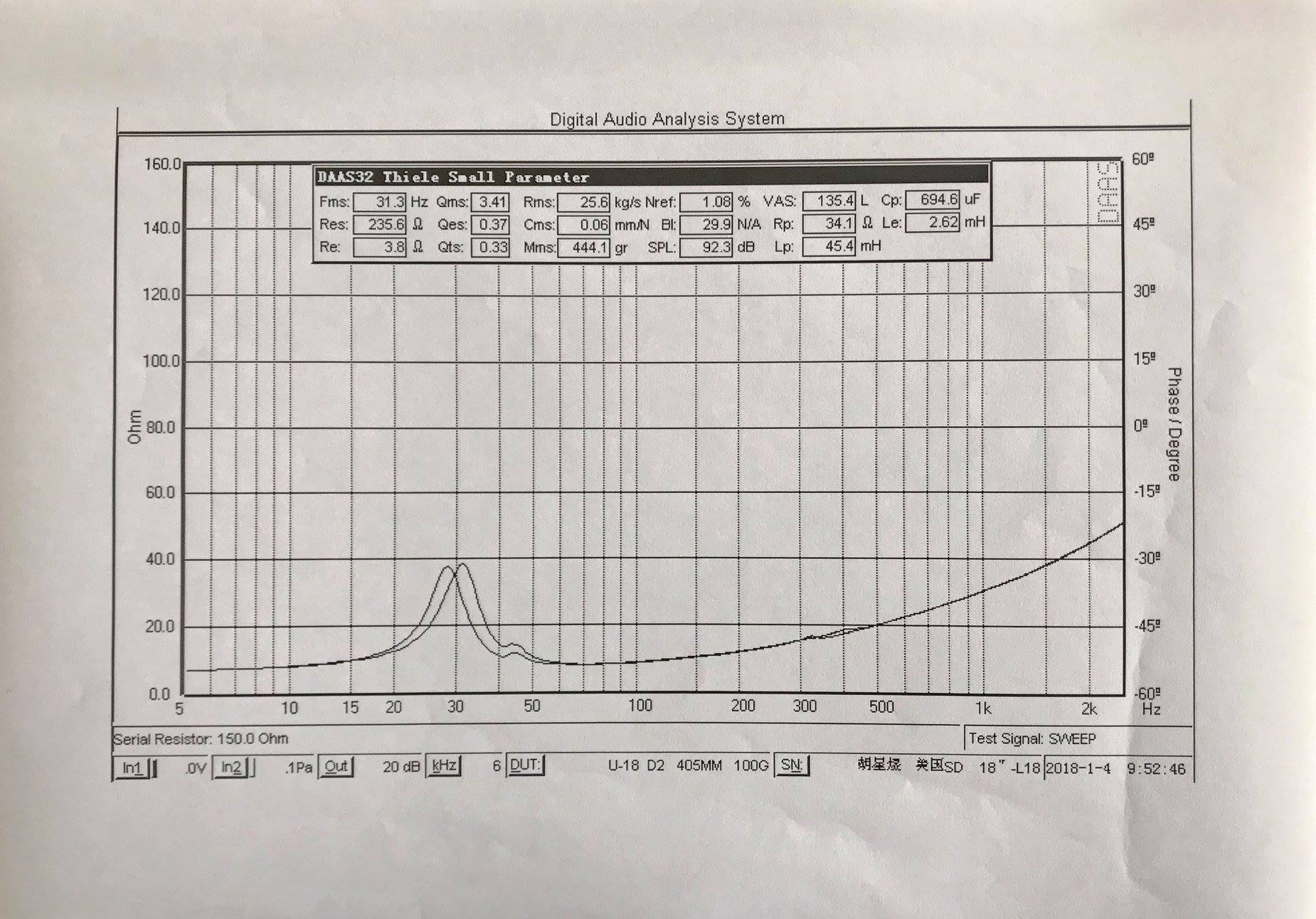

However one thing that is a little interesting is that this node seems to appear on all the sweeps that Sundown conducted; the U10, U15, U18 attached below respectively.

I think it would be a low probability to insecurely mount the woofer in every case. That leads me to believe that this is inherent to this woofer or possibly the DAAS32 system has some problem (however this does not appear in Sundown's published sweeps that I have seen for other lines of their woofers X-series, Z-series, etc...).
This suggests an error in their measurement process (like the resonance issue previously mentioned), rather than a unique feature of the woofers. If the additional and unexpected peak in impedance appears around the same frequency in every measurement, then I'd say that it's definitely a measurement process error.
