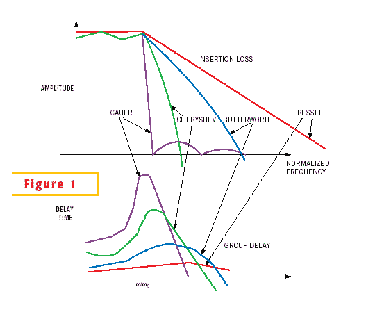

What does a filter response look like?
see an example at the most current issue of EDN:
http://www.e-insite.net/ednmag/index.asp?layout=article&articleid=CA302235&pubdate=6/12/2003
hmm. interesting that it seems like filters with a higher change in slope also have a higher change in group-delay. i don't think i particularly like that idea. since in my design, the tweeter will be located near the midwoofer, i may just use a 4th order filter like everyone else.
