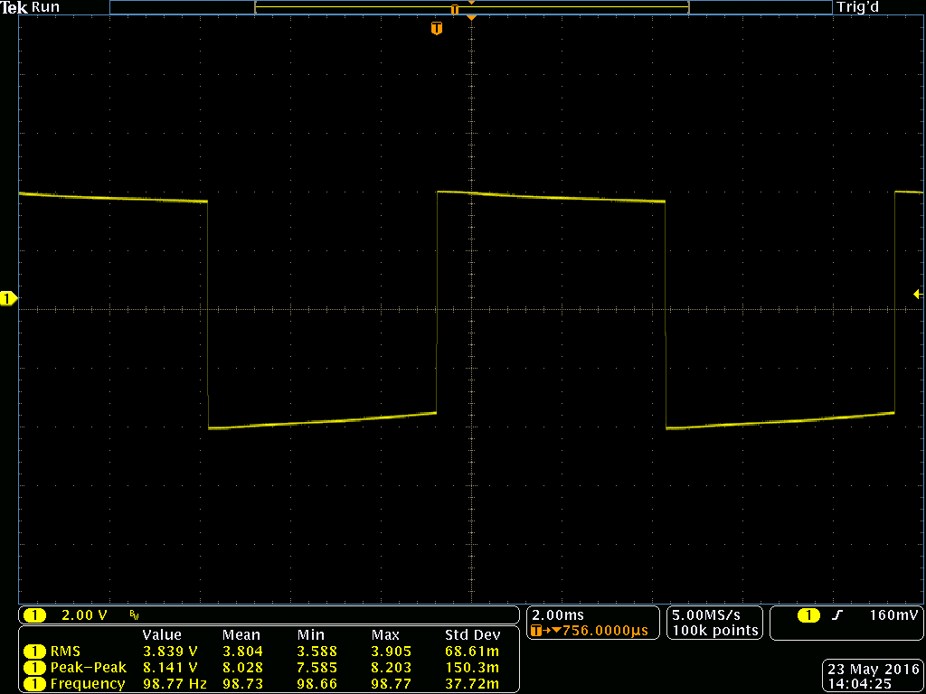

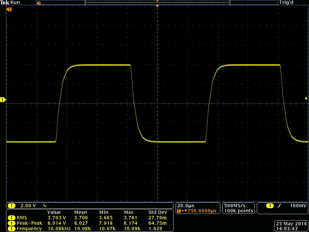

I also wanted to explore the high-frequency performance of low-ratio OPTs, where cheap iron can actually gain the advantage. We know that leakage inductance is proportional to the square of turns ratio, and the $12 MCM transformer does exhibit very low leakage inductance. Its Lpss is only 3.9mH at 1KHz in the configuration used here (11:1). At 2W output, using 12dB feedback, the resulting frequency response is down only -1dB at 26KHz and -3dB at 49KHz. Squarewaves are excellent; see attachments.

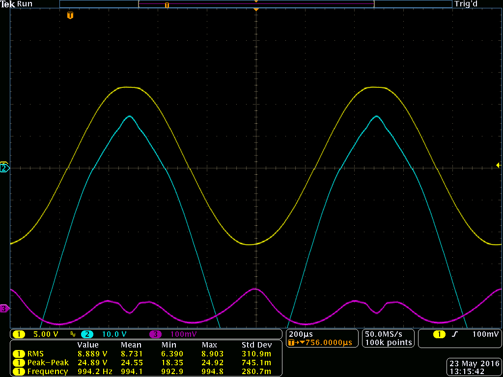

The attachment shows what happens at the onset of clipping. Speaker output is the yellow trace, the control grid is aqua, and purple is THD analyzer residual. The grid is driven about 16V positive including a sharper hump where anode current limits out. That's a result of feedback attempting to make the output signal match the input signal. The correlated dip in the distortion waveform is simply the result of a flattened peak in the output signal. Limiting looks a bit different on the negative output excursion because the tube is approaching cutoff in this case, and cutoff occurs more gradually.
So you're puting 80v p-p in, it looks like on the scope, 10v/div.. That gives 200v p-p out with 200v on the anode?
Grid drive reaches about 80Vpp max, which yields something over 300Vpp at the anode. The 200Vpp (70.7Vrms) figure on the schematic is the nominal value for 5W output, ignoring transformer insertion loss and actual turns ratio.
