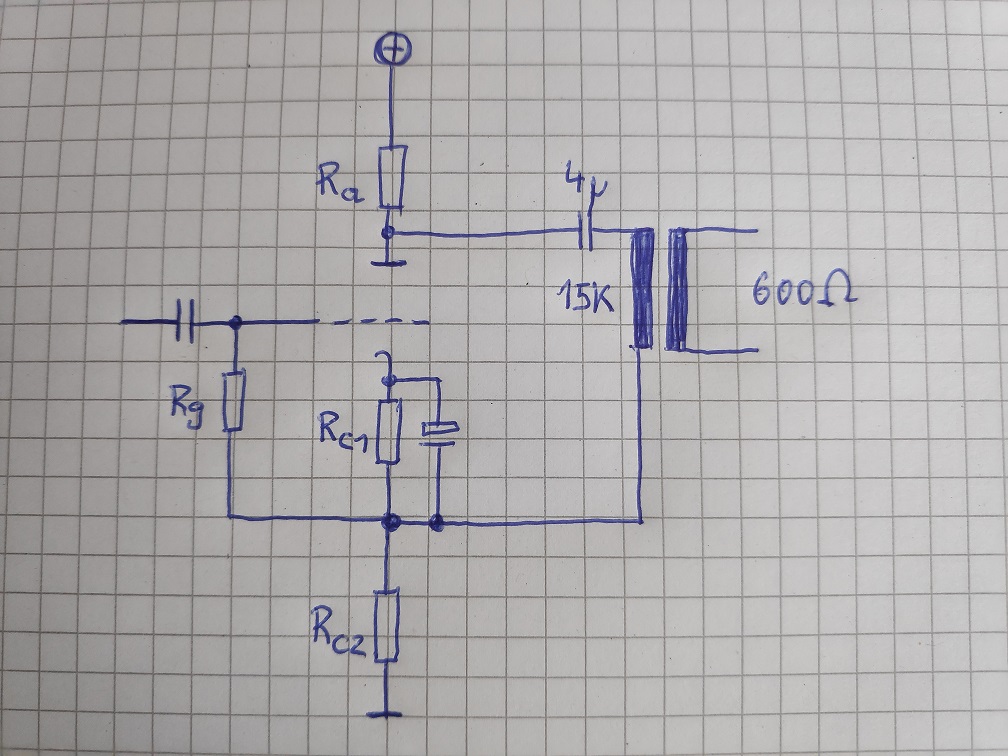

Hello,
want to build a Cathodyne tube line pre.
Could this schemo be a good starting point for the design?
Is a single ended 15K:600 Ohm output trannie of any use for this circuit?
Or will the output resistance of the circuit be too high and a different tranie must be used?
Many thanks for checking the schemo.
A "cathodyne" is the same thing as a "split load phase inverter".
What your schematic shows is a simple parafeed amplifier, except with an anode load resistor instead of an inductor or constant current source as the anode load.
Do you need a phase splitter?

But it is not a real parafeed amp.
Only if you put a bypass capacitor across Rc will it become a parafeed amp.
And by the way, it will perform better as a parafeed that way, than it will perform
as the Cathodyne circuit that was first drawn.
Schmitz77,
But why would you build it as a cathodyne?
Only to show it could be done.
1. The driving impedance to the transformer limits what transformer you have to use,
and even a really good transformer will have frequency response problems, rolling off at low frequencies, and rolling off at high frequencies.
You can use a Power tube, relatively low values for Rp and Rc, and stand lots of current, that will make for a lower impedance to drive the transformer, but what a power waste, and hot too.
2. The gain to the primary is limited (to 2x?, my brain hurts to much now to think about how to calculate that).
And the voltage loss in the transformer is 5:1 (0.2). 2 X 0.2 = 0.4 total gain, not a real line amp.
3. The output impedance of the line amp will very high, unless the primary to secondary turns ratio is high. That will reduce the gain, and further reduce the bandwidth. Or back to the power tube solution.
4. In a Cathodyne, Ra and Rc are equal. That means the grid has to be at a rather large positive voltage, just like all other cathodyne amps.
5. With a lower Rc resistance, and a bypass cap across Rc, the plate resistance goes down, and this becomes a practical parafeed amp (like the output transformer does not need as many laminations, does not need an air gap, and can have reasonable bandwidth). The tube gain goes up, and could overcome the 0.2 x voltage reduction of the output transformer, providing gain lots higher than unity.
That is just about all the reasons I can think of why it should not be built as a cathodyne.

Are you looking for a balanced output, a floating output, or what?
Just looking for a superior sounding parafeed 600 Ohm output stage beside an ordinary cathode follower.
Ken Shindo seems to do the output stage of his preamps this way, so I'm interested to do it the same way. Any cathode follower has its pros and cons, but in general it's not known to be the best of all audio circuits. I want to do something different, something better in the circuit.

Thanks for the explanation of its cons.
But Shindo Labo seems to use such a nasty circuit with all its disadvantages in their top models like Petrus. How can THEY bring the circuit to perform top notch? Thats what I'm asking.

Because they may be using a true cathodyne. The circuit you posted does not not appear to be a cathodyne; it is an ordinary gain stage. With a true cathodyne the grid needs to be biased up to a higher voltage, so Ra and Rc can be made equal. A true cathodyne will give you very low output impedance.

So what are the benefits we see with using this circuit and why (maybe) Shindo labs is preferring it to a parefeed output on a cathode follower?
-low output impedance, but source impedance of plate and cathode are different
-cathode resistor only half the value of a cathode follower-> less negative feedback->better sound?
-true symmetrical output for better noise suppression
-half the output swing available compared to a tube voltage gain stage, but inverse polarity of each output makes it a zero gain stage like a cathode follower
-very low distortion created in this cathodyn stage, because half the total output is used as voltage feedback
-the stability of balance between the two outputs is excellent because of the same values for plate and cathode resistors. A true balanced circuit.
A lot of pros for this circuit in advance to a cathode follower.
Thanks, Merlinb.
No they are the same. Anyway, the transformer is connected between the outputs so its sees only one output impedance; roughly 2/gm.
A bit of audio mythology there...
There may be a PSRR advantage but it depends on the overall circuit topology (hum cancellation).
No, it is the same! The transformer is conected between the outputs!
Unless, of course, he uses two identical chokes for loading the plate and cathode and their low DCR can set the bias for the cathode renders no need for an elevated grid as illustrated in the Broskie article. Of course that's a lot of irons (and expensive) for a real world project.
