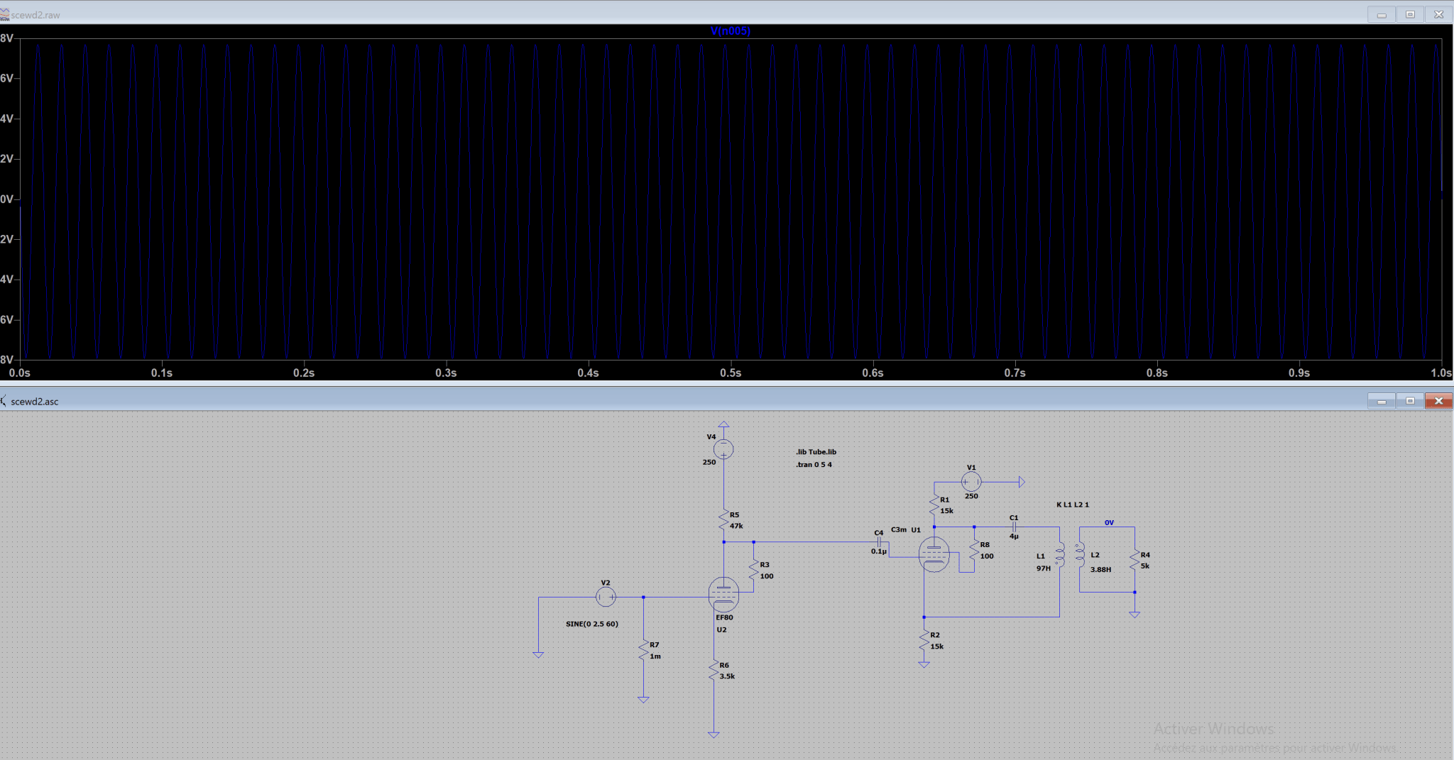

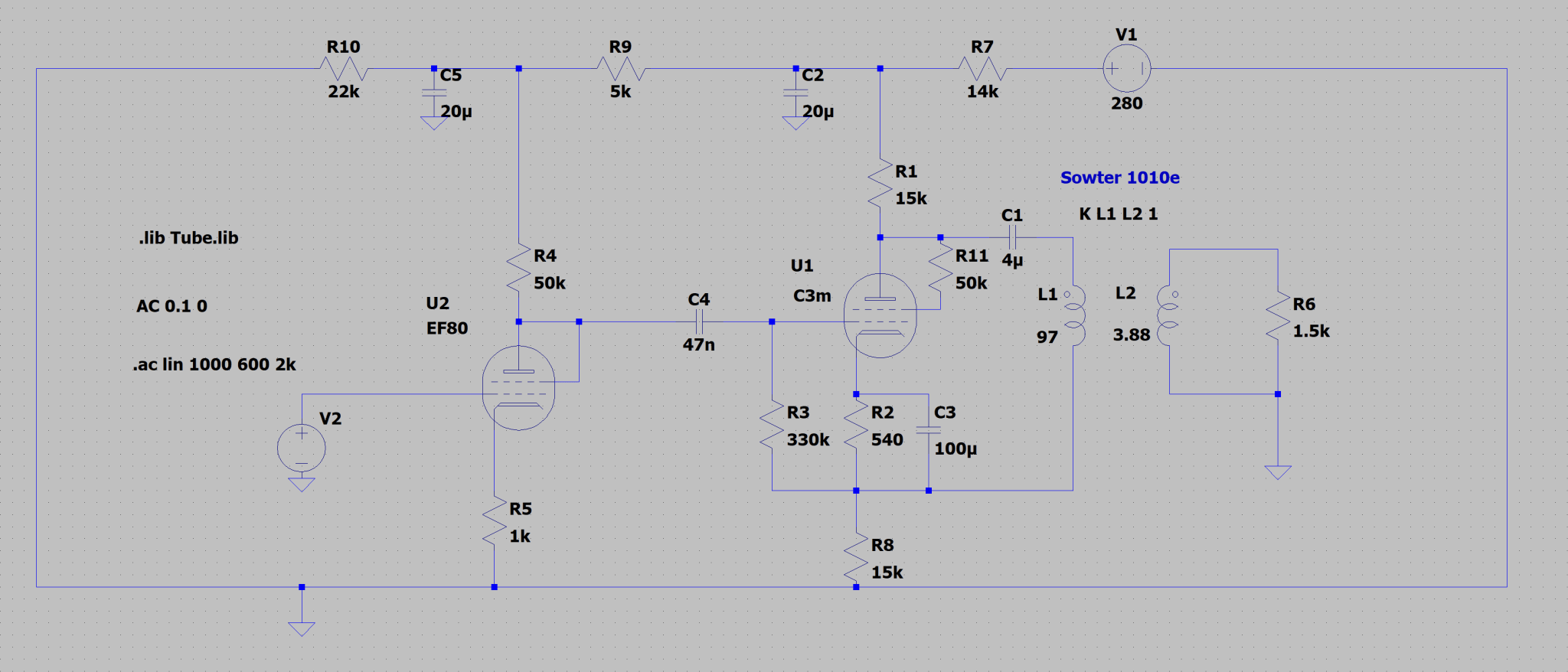

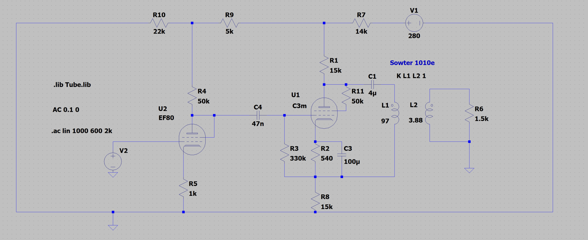

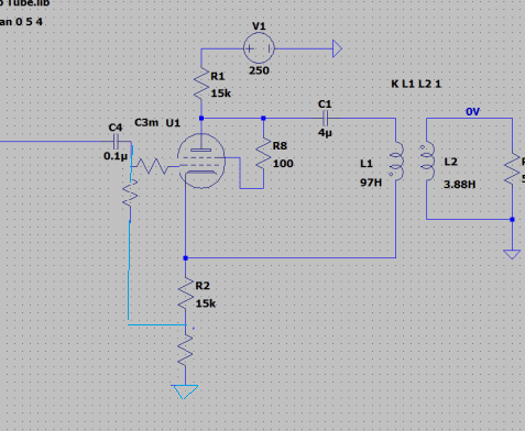

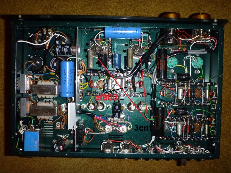

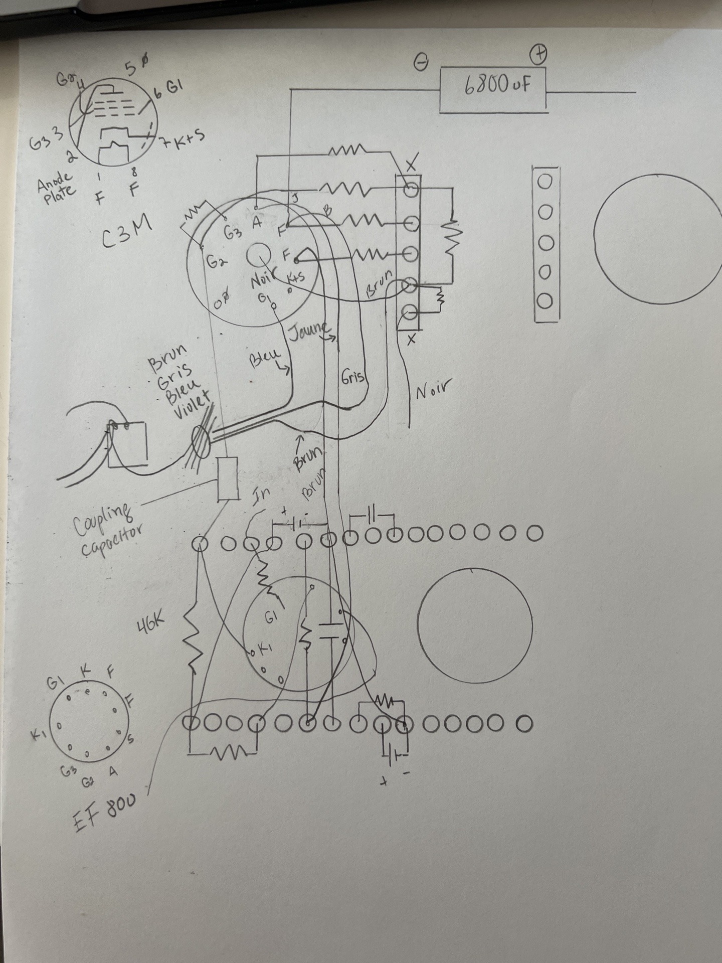

Z zonula Member Joined 2010 2024-07-19 1:44 pm #22 2024-07-19 1:44 pm #22 Still cooking ;-)))))) Z zonula Member Joined 2010 2024-07-22 3:17 pm #23 2024-07-22 3:17 pm #23 Updating my progress, yes I know no values indicated in my schematic Z zonula Member Joined 2010 2024-07-22 3:21 pm #24 2024-07-22 3:21 pm #24 I found also a pic of the bigger brother (read Petrus), I thought I'd share with you all ;-) Prev 1 2 First Prev 2 of 2 Go to page Go You must log in or register to reply here. Share: Facebook X (Twitter) LinkedIn Reddit Pinterest Tumblr WhatsApp Email Link
