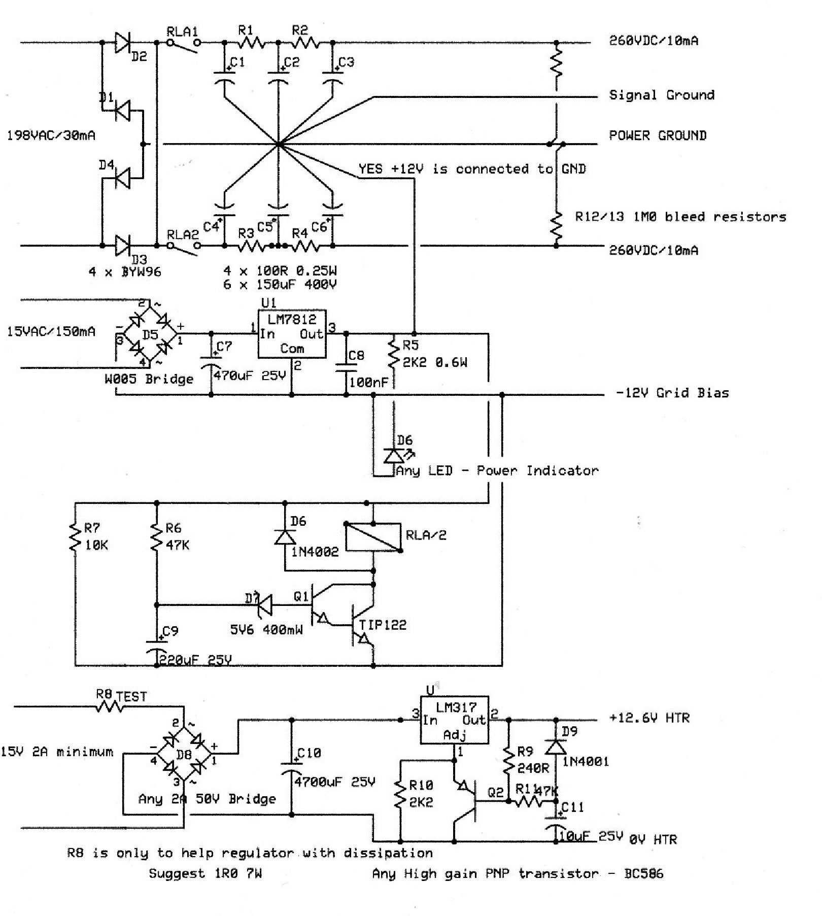

In this case I would feed the heaters with an LM317 CCS using a slow start and apply the B+ a few seconds later. It costs pennies to achieve and will give you piece of mind.
I've attached the PSU that I used with my Borbelly Pre-Amp.
VERY TRUE that 60s and 70s amps didn't use or need any form of protection, but then valves were ten a penny.
If you take a normal light bulb, they rarely fail in operation, they nearly always "pop" when you turn them ON. Hence the slow start on the valve heaters.
Cathode stripping is SNAKE OIL, but its easy to implement a delay in applying B+ without compromising sound quality.
