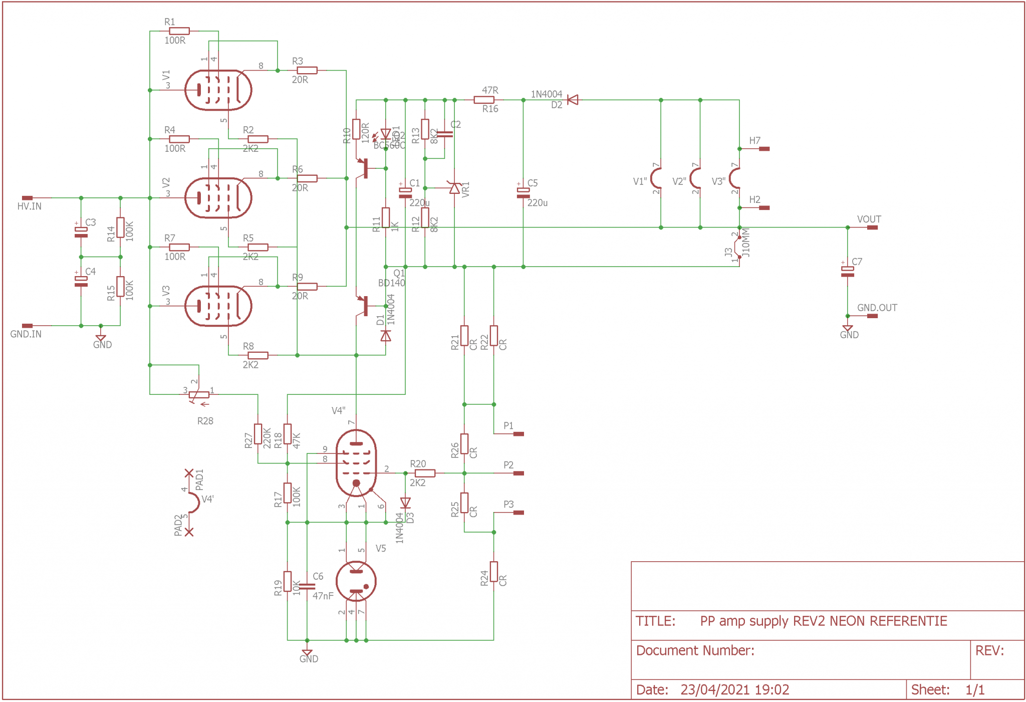

I quite agree, I nearly always tie the load/current source resistor of the control tube driving the pass to the unregulated side!Under heavy load the grid of the passer needs to be pulled up close to the cathode.
So for example a 6AU6 or whatever is used, its plate resistor needs to go to a much more +ve place.
In common designs that is often the raw DC out of the Rectifier/Filter combo.
Some designs pull that up even further.
Some volk try running the subject plate to the regulated +ve lead. Sometimes in such designs
the regulator locks up & refuses to start.😱

I'm not too fond of the added complexity of a cathode follower to drive pass tube grids, for normal tubes that have non-existent grid current its much easier to use a 5-10mA CCS with a frame grid construction pentode error amplifier like EF184 or E83F. Current source loading allows for higher gain, and none of the drawbacks of multiple tubes.
If you use a high impedance current source like a PNP cascode fed from the single wave rectified pass tubes heaters, you can get amazing results.
If you want to do something with cheap tubes, you can use two PCF80 one as a long tailed pair with 85A2 reference, feeding a pentode half VAS and use the second triode for follower duty. You would need a 0A2 reference tube to keep the cathode of the pentode VAS at +150V
Heaters for the PCF80 would be referenced to +200V or so to keep all the heater isolation within spec for up to 350V output voltage.
