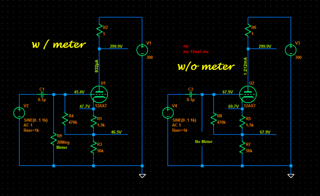

I built a self-biased 12AX7 cathode follower with the usual sort of values:
Rk bias resistor 1k5
RL cathode load resistor 56k
Rg grid-leak 470k tied to junction of Rk and RL
When I power it up from a 300V supply, there is about 70V at the tube cathode, about a volt and a half across Rk but the grid is at about 45V. I have built this using different sockets, different tubes, and different resistors and the voltages always come up weird.
If I short RL then the grid is at zero volts, cathode at 1V5. The current through the tube seems the same either way.
I thought maybe there was something going on during the warm-up and added a grid protection diode. This did not change anything.
With the voltages present I would expect the tube to be off, but it works and passes signals like it should. The DSO 100MHz scope shows no oscillations or noise.
How can this be? Does anyone have any ideas?

I made a mistake, a meter resistance far greater than 1 Mohm, about 20 Mohm in fact, can cause the problem because the cathode follows the grid.
The input resistance is about 13 Mohm, if I calculated it correctly. That's Rg (1 + RL/(Rk + 1/gm)) + RL. A resistance of 23 Mohm to ground then reduces the voltage from 70 V to 45 V.
The calculation may be a bit too pessimistic because I neglected the effect of the valve's internal resistance. That should make it a bit better, but not much. All in all, I estimate that your meter has an input resistance of about 20 Mohm and that that causes the issue.

Your measurements are correct if your meter has DC resistance of 20 Mohm.
See the simulation w/ and w/o meter connected to grid ...

Aside from Sorento's brilliant diagram: it is good to have two meters. Monitor the cathode with a semi-cheap meter while you poke the grid with the good meter. The cathode voltage drops!! A clue that you are upsetting the circuit in a way that may not happen in normal life.
It's essentially bootstrapping, bootstrapping increases the input resistance from 470 kohm to just over 10 Mohm. What you can measure is this:
The voltage to ground at the node where Rk, RL and Rg are connected to each other
The voltage across the grid resistor (one meter terminal connected to one side and the other to the other side of the resistor, so the meter is in parallel with the resistor)
You can then calculate the grid voltage.

I did a simulation and it had all the expected voltages on it but I did not think to add the meter resistance. It makes perfect sense that the meter would upset the CF.
