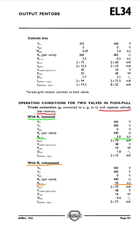

But isn't the "Ra-a" listed the OPT impedance, and not the Ra of the valve itself?
If I figure a 2k ra (from TG earlier bit of math), then bypassed the 6P6S isn't far from the EL34 data above, if I assume that the ra:Ra is about 1:3.
Of course, my situation is complicated by...plate to grid, not played to plate, local feedback to give about 3.5 to 4V/V gain.
So I have that degeneration, as well as the cathode😀
Ra-a is the load impedance indeed.
I just mean that leaving Rk unbypassed might work if you increase the load.
EL34's ra is about 1.1k and ra' is about 4.6k for the OP stated in the datasheet.
