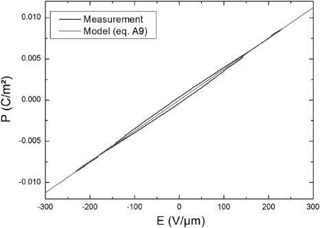

Kudos does not count; evidence does. SB may have seen hysteresis, but he presents no evidence for this. The most likely explanation for an X-Y trace opening in the middle is phase shift; hysteresis would require non-linearity at the ends too. He may have seen this, but his pictures don't show it.
I think Steve Bench did see dielectric hysteresis.
It is very common that the scale factors affect the look of the graphics.
It is also notably that Mr Bench not accustomed to scientific publications, is not clear, at least for me, nor the experimental setup neither a theoretical introduction, etc.
This is also consistent with the conclusions of this thread, if the applied voltage on the capacitor is small enough, the dielectric hysteresis curve approaches a straight line.
