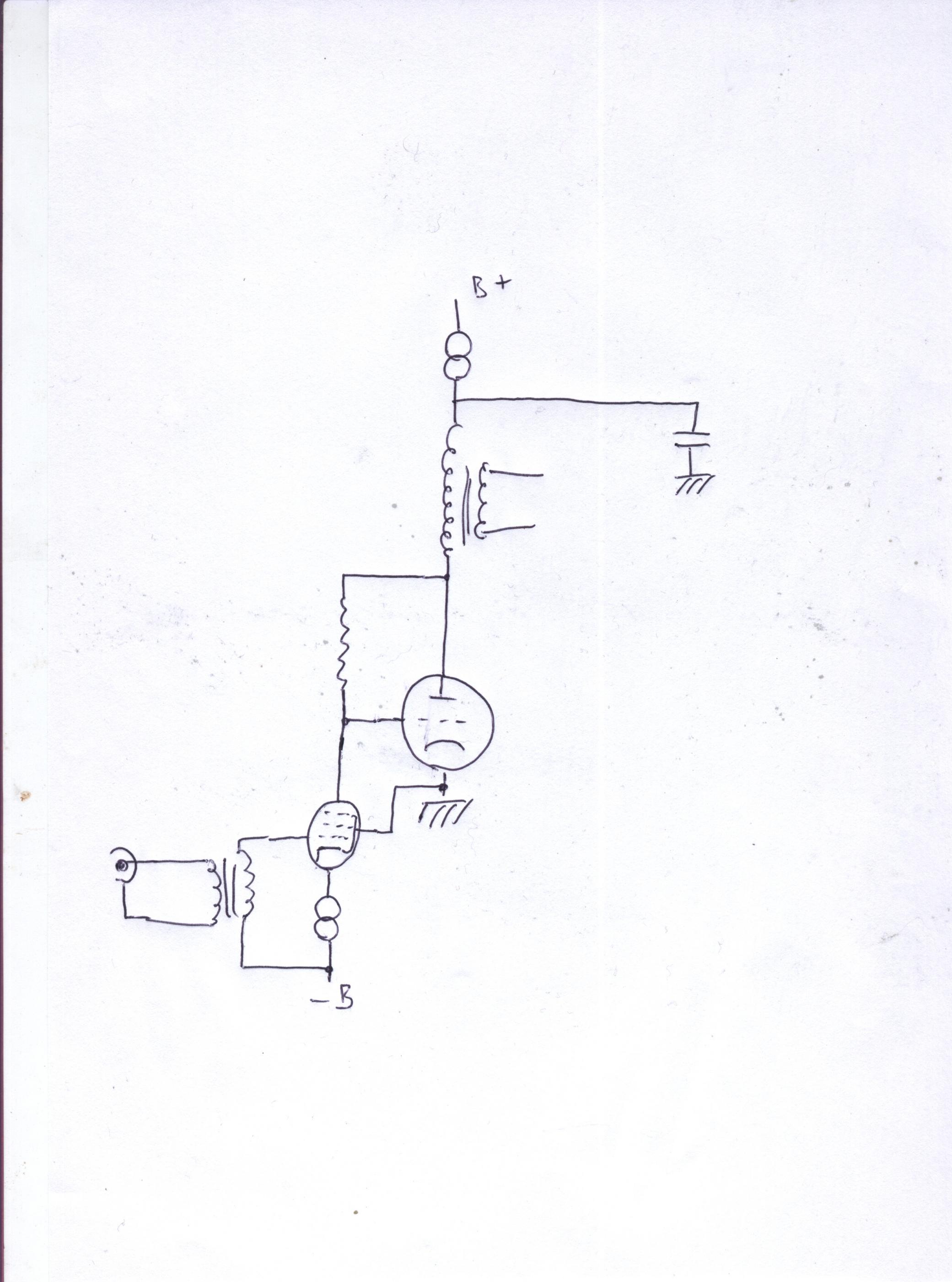

Interesting. If you have an idea for a DC coupled 2 stage cathode bypass-less concept do share. I can run simulations. What I have seen in the past adds so much complexity as to make the amp too big and complex.
It looks like you killed the voltage amplification in the first stage by adding a CCS in the cathode?This illustrates the basic principle.
Both are self adjusting and intrinsically safe in operation due to the two CCS which maintain bias and prevent current runaway.
Indeed you are right in this case and I missed it - but think of it as a PP with a LTP to see how it should work in the builds I have implemented.It looks like you killed the voltage amplification in the first stage by adding a CCS in the cathode?
You would have to put the bypass cap in to make it work, but at least there are other advantages it brings to the table.
I think it would probably still work fine if you replaced the bottom CCS with a resistor - but initial setup would be must more difficult and critical.
Shoog
In 1929 Loftin and White had limited technology at their disposal. They did the best they could with what they had. Their compromises do not have to be our compromises; I'm sure they would find it amusing/perplexing that anyone today might put them or their designs on a pedestal.regal said:Loftwin & White made a very bad design, you heard it here first.
See here for a description of what they did and why.
So... we've got rid of that pesky coupling capacitor and replaced it with a coupling transformer. Progress at last! Wait..what?
