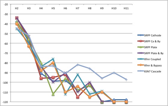

I've seen this before and I find it difficult to interpret the data when it's split up into even and odd harmonics. I prefer to see all the harmonics on the same chart. And I think this is important because of the psychoacoustic affects that lower order harmonics have in masking higher order harmonics.
I've recast the data to match my preference (attached). All these curves look very good by the way. But what I notice is that the differences show up when we get to the 5th harmonic - generally a bad sounding one. The Xfmr coupled result (without bypass) looks bad, it has a high 7th too which is bad again. The SRPP Plate looks very good - really low 5th and the only harmonic pushing above the -100dB level is the 6th - and only just. The SRPP Cathode is also very good. The SRPP would be my pick from the data. And that would be in conflict with what the article says.

Bigun,
The main reason for showing odd harmonics separately is that they are the troublesome ones; as I understand, particularly 7th and 11th, but also others. Even harmonics are for the most octaves above the fundamental and not disharmoneous. That is not to say thay should be ignored, but if one prefers to look at odd harmonics the figures for even ones will unnecessarily 'clog up' a graph or table.
I read what you say, Bigun - need to brush up my psycho-acoustics.
I once saw data where higher odd-harmonics and some I.M. products of the same could be noticed even when as low as the threshold of hearing. But that was a long time ago. As said, I will Google psycho-acoustics again and brush up. Thanks for the heads-up.
Harmonic Distortion and Intermodulation Distortion is produced (simultaneously) by the same mechanism, namely mixing of signals in a non-linear system.
Higher order harmonic distortions are accompanied by many more Intermodulation Sidebands
Even harmonic distortions are accompanied by IM Sidebands remote from the original frequencies
Odd harmonic distortion are accompanied by IM Sidebands close to the original frequencies (and therefore more objectionable).
As Johan states the 7th and 11th Harmonics are musically "quint" and are therefore very objectionable, even levels 0f 0.001% of these are fingernails down the chalkboard stuff, it just grates.
