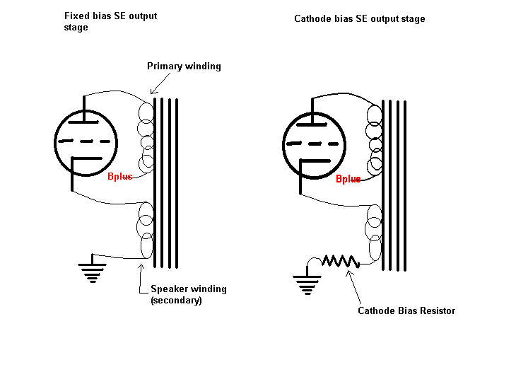

Hello George,
could you explain me a thing? From your words I understand that CFB works only with fixed bias, because you're grounding the cathode from a DC point of view. It's possibile to use cathode bias?
Diagram of what I've understand attached (sorry for using Paint):
You can use cathode feedback with cathode bias, but rather than putting the cathode resistor below the winding (as in your drawing) put it above. You now have one of your loudspeaker terminals grounded. There will be a small DC offset at the other loudspeaker terminal due to the DC voltage drop across the transformer's secondary resistance, but it's not usually a problem. You almost certainly want to bypass the cathode resistor with a capacitor.
Thank you very much.
And what about a PP output stage (fixed or cathode bias I see it's unimportant)? If I use a common cathode resistor, can I put the secondary between that resistor and ground? What sonic effects should I have? I'm expecting that it cannot work, since I ideally need 2 separate out-of-phase secondaries, one for each "side" of the PP tubes (if only 2 tubes, one for each tube). Maybe using a 0-8-16ohm speaker taps, you can ground the 8ohm one, use the 0 as the positive for you speakers and use the 0 and 16 as two separate cathode windings.
But this way you'll have speaker back EMF feed back to only one of the output tubes, or am I wrong?
EC8010 is right, just put the resistor (with a cap across it) between the cathode and the transformer. Many pentodes are terribly non linear in the region near positive grid bias, so PowerDrive may not be a serious advantage here. I am using it in the current prototype because I wired 6AV5's into my 300B amp. I will do a lot more testing when I return from an upcomming trip (mid April).
