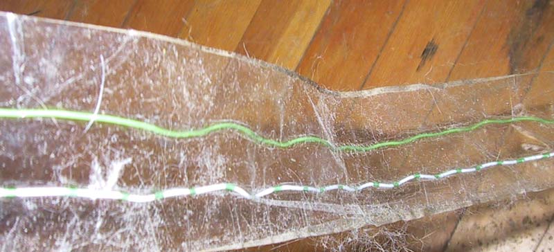

I just made a set of speakers cables using old telephone wire (for fixed installation behind the wall), it's 24 AWG solid just like cat5 but much easier to untwist.
I untwisted 4m of wire, one pair for each speaker. I stretched it out and sticky taped the ends to a linoleum floor an inch apart and ran over the top with packaging tape, then peeled it off the floor foot by foot and folded the edges of the tape over the wires. I stuck it down again with the sticky side up and repeated the taping process from the other side. The tape does make a mess of the polish on the floor but that's a minor issue compared to She Who Must Be Acknowledged's reaction to crinkly bits of old packaging tape draped across the living room floor.
My big ugly amp has a huge damping factor, I think I need still more resistance to bring the bass up. But these 20 minute cables make it much more enjoyable to listen to.
I didn't bother twisting it, I dont have any RF issues.
