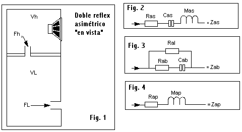

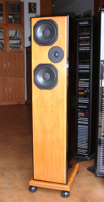

A friend of mine in Italy and I put together a project with the Castle Winchester's 16 ohm woofers. We purchased them from a former Castle products distributor as surplus units. High Qt and Fs if I remember correctly. However, our cabinets were dual series bass reflex, not the Castle TQWT lineup.
Jusgt a box?
Gven the aspect ratio of the box, if just a box, it is an ML-TL, not a reflex.
dave
INTERESTING Did they turn out well? they look great. Do you have the contact info for the supplier?

No, it was a long time ago, but I remember that the volume is vertically divided 1/3 2/3, the smaller chamber connects to the larger part through a single round hole and the final (larger) volume is tuned by a duct. to the ground through the wheeled base that can be seen in the photo. Like this, but fh not ducted and fl facing the floorJusgt a box?
