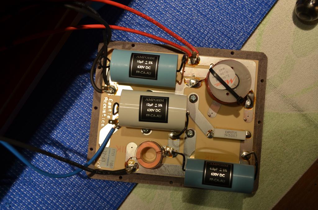

This network closely follows the topology ( fwiw ) of the one seen in the pic that I posted ( albiet adjusted for the lower impedance drivers ).
The most significant change is the addition of a notch filter on the twin woofers ( though it might not be needed if the real "tested" response ends up being flatter than the product sheet indicates ).

I managed to trace the original harlech crossovers ,on the bass section it is a 1.50 mh inductor and a 10 uf cap used as a flattening zobel on the 2nd pole which flattens the impedance of the bass units the 1 ohm resistor in parallel with the 10 uf cap apparently modulates the impedance to make the units when run in parallel look more like 5 ohms than 4 ohms .......i was wondering if you could run that circuit with the monacor units in your xsim program and see what adjustments can be made to suit the monacor units?
many thanks in advance

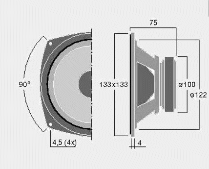

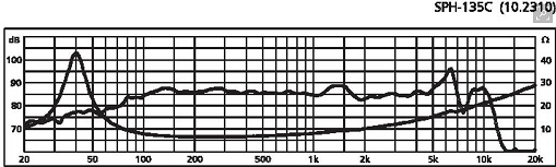

Best use the replacement Carbon Fibre 5" Monacor SPH135C in the top firing position:
688887d1530022817-castle-harlech-s2-front-top-mid-driver-x2-monacor-sph-135c-png
Bit of a typical bump at around 1.4kHz there, and some typical Kevlar or Carbon Fibre breakup at 6kHz. Sort of breakup thing polycones are better at.
The crossover is basic enough, whatever the exact details. Around 2.5kHz XO. You would need quite a bit of work to get it to monitor flatness, but most people can live with these imperfections. Actually a speaker that works with the room to get a reasonable power response IMO. I suppose it might be a bit thin on vocals in Castle's layout.
The red resistors are adjustable, though the 1R does next to nothing anyway. The 2.2R will adjust tweeter brightness.
