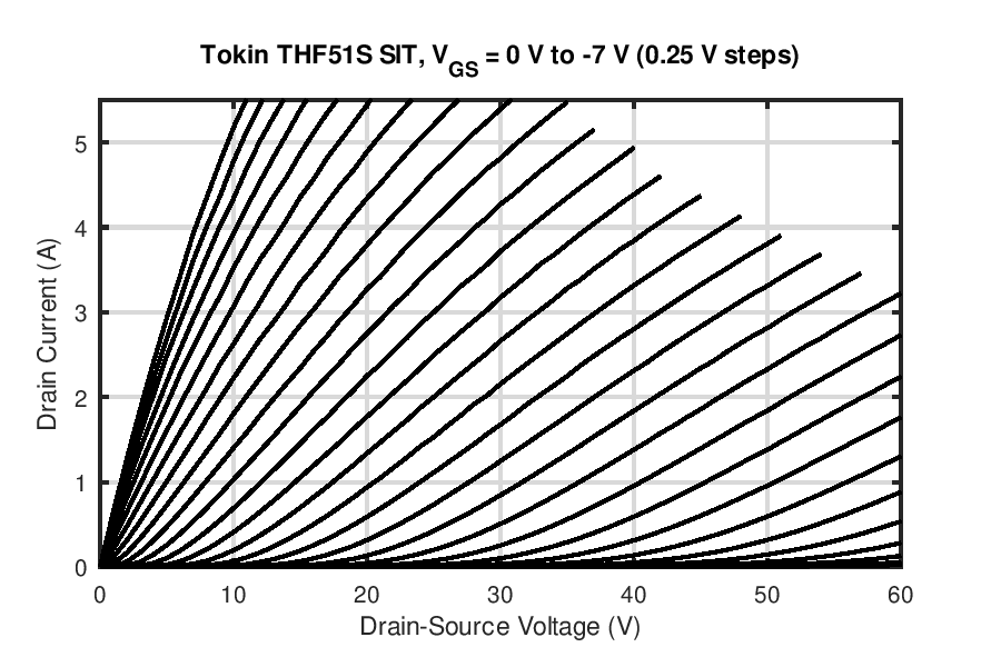

N. Pass is using SITs in his SIT-5 (common drain) amplifier. SITs have also been compared in common source and common drain configurations and have been preferred as followers by some people who prefer SITs over FETs.
Not using output transformers...
I have built power amplifiers and preamplifiers using SITs. My SIT power amplifiers include common source and common drain output stages. I also have a transformer interstage coupled SIT amp (source follower) with output transformer. Additionally, I have built preamps and amps using power JFETs.

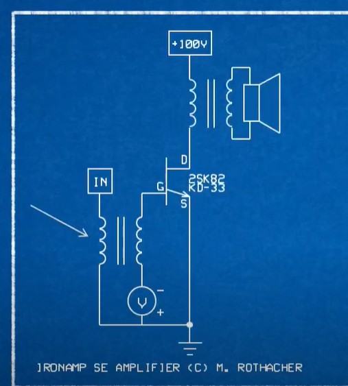

@pinholer - thank you, my point exactly, doesn't matter what and when one did something, there's always room for improvements... 🙂 From my experience with tubes I know that OTLs (output transformerless) work beautifully on paper but in reality the listening experience isn't as cheerful... and of course this is because a very tight tuning of impedances and operating points is involved, same as when considering transistors...
@analog_sa ... you mean "step down" xfmr, in most of the cases, in order to "save" an OTL ... as in higher voltage, lower current, finding a more linear area of operation, what's so difficult to grasp? Finding a proper load line in accordance with 8 ohm speaker impedance is not so easy with tubes and I bet SSs can have better operating areas/points provided that an impedance conversion is properly employed.
Have it your way, of course, I'll dig further based on my misconceptions... 🙂
@analog_sa ... you mean "step down" xfm🙂
No. i meant step up, referring to your schematic in post #1. It is a step up, right?
That is a "mild" step up, with lower THD than 1:1, in simulation at least... and by increasing the voltages can be as well a step down, but I didn't spend too much time playing with that simulation, just enough to see that above 10kHz a low impedance driver is needed 🙁No. i meant step up, referring to your schematic in post #1. It is a step up, right?
