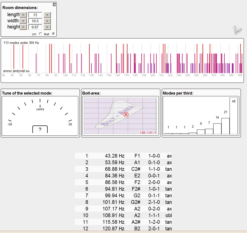

He asked about problems he is having with room modes and his woofer EMINENCE ALPHA 15 A in a dipole. He mentioned the room dimensions, in the same thread, with a waterfall attachment for the same driver.
Hi! The dimensions are 13' L x 10.5 W x 6.8' H. 3 walls are drywall over cinderblock, one short wall is drywall/metal studs. Floor is concrete, ceiling is drop acoustic tile under the wooden floor of the 1st floor. A couple 34" face "superchunk" mineral wool traps in the front corners, a few 4" thick 2'x4' at the side reflection points.
Here's a waterfall I ran for just the sub from the listening position (that chair). I think that ringing at ~40Hz is the axial mode as that's still being excited given that's the axis the sub is pointing along :
Thanks!
After checking for bad modes and proportions of the listening room, nothing was found. This is, the modes are there but the room proportions can be classified as good room ratios (shadow Bolt-area) after Bolt. In this case this is the approximate dimensions ratio (#1 below):
1 : 1.57 : 1.95
But, the first length Modal resonance is ~43 Hz.
The first height Modal resonance is ~84 Hz, and the second length Modal resonance is ~86 Hz. So, very close but nothing very bad here for a home studio. We could check better with real dimensions for behind the drywall that is over the cinderblocks, but I think that's not necessary because might not be the culprit.

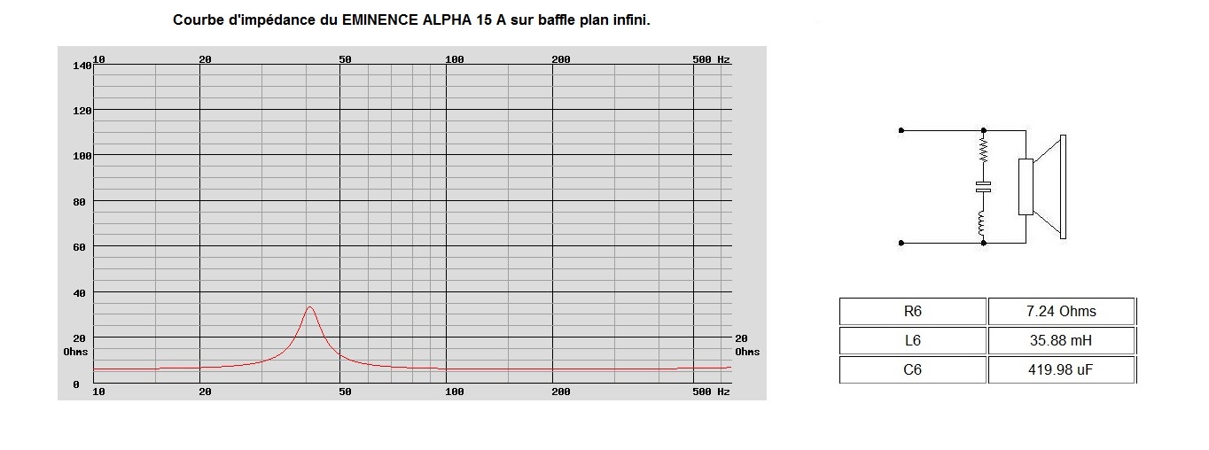

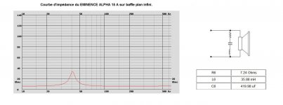

If we look at this woofer (pic of the linked post), ALPHA 15 A, the mounted resonance (Fsp) is 41Hz. So as a first guess I would say and concentrate in this problem. We have a speaker with 41Hz maximum impedance and a room length with a bad mode at the closest frequency of 43Hz. Usually in other cases a passive series RLC is used (#2) to attenuate the resonance of the driver.
