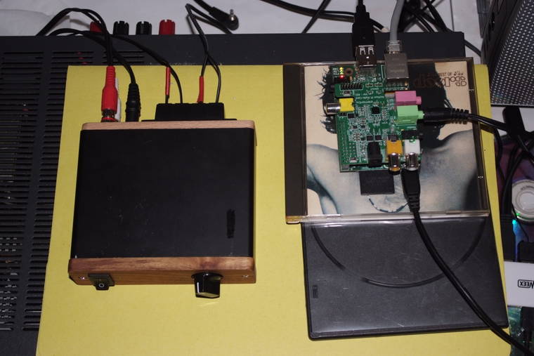

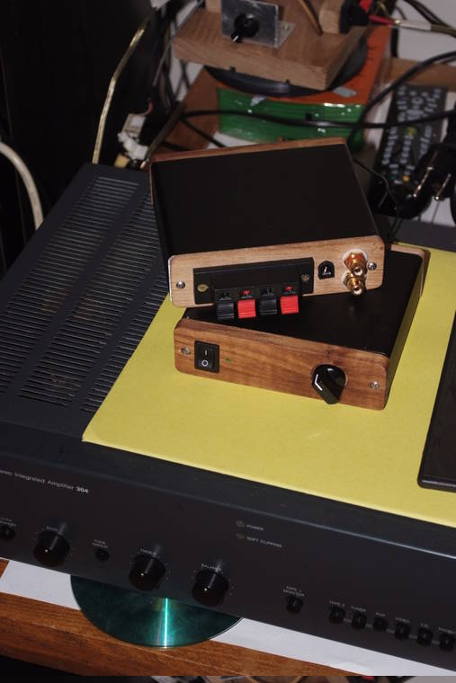

I used one of these Sure cases from Parts Express, less than $10, for my modded TPA 3116 board.
https://www.parts-express.com/aluminum-amplifier-case-193-h-x-294-w-x-472-d--320-328
Thanks for the tip! That's a nice box for $10.
The box is really a bargain, and very well made. However, you do have to rework some things.
The box is designed for a volume pot, so you will need to make or buy a knob.
On/off switch has a slot instead of a round hole, so I drilled a hole to accept the pot.
Also, I needed to increase the depth of the counterbore on the back side so the threads of the pot would reach through the front.
On the back, the power jack opening is square, so I used a small sheet of carbon fiber, but a piece of aluminum would work too. This is to cover the hole from the back with 2 screws and nuts attaching it. Then a new round hole can be drilled to fit the DC jack.
I had to open the binding post hole sizes slightly wit a step drill.
The TPA 3116 YJ Blue/Blk. board will fit snugly in this box.
