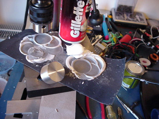

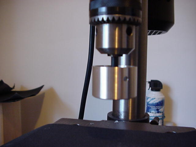

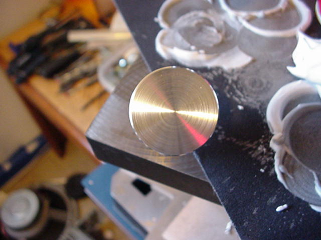

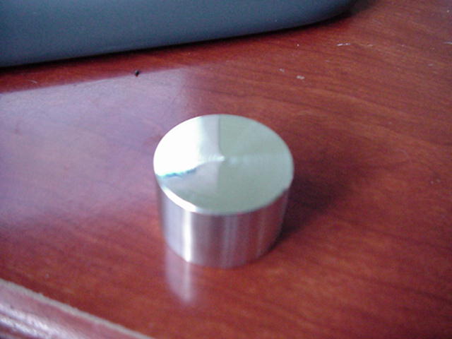

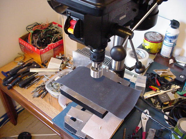

repairing that aluminum knob
not sure if it would work with other ones but i have this solid
aluminum knob that had some scratches. not anymore.
i used a drill press. i first tryed oil on the sandpaper but it went
all over. hmm i have a idea lets try shaving cream and guess what it works. here are few pics😉

NICE WORK KARMA
Nice work, I have a few knobs I will try this technique with.
Hey is that the JOBMATE drill press Canadian Tire had on sale a while back? I purchased one while I was in Hamilton and with the rebate it cost less than $30 (thats CAN$)
