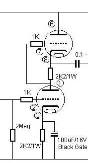

You can view a cascode as a "synthetic" pentode. Like a pentode it offers greatly reduced Miller capacitance and large single stage gain. It too has a very high O/P impedance. Unlike a pentode, cascoded triodes don't introduce partition noise. The PSRR of cascodes is WRETCHED, which makes regulated B+ a must.
Cascodes that function well employ triode's with high gm, at the bottom of the stack. Gain in cascodes is roughly = (gmLower Device) (net ZL).
BTW, the example you provided is a SRPP, not a cascode. Both arrangements are examples of "Totem Poles".
hey-Hey!!!,
As Eli said, the circuit characteristics are for the most part based on the bottom triode. There are a few important characteristics that depend strongly on the upper element. Ability to swing close to its control grid voltage being the most important; this is a pentode that can't come any where near driving its plate below its 'g2'. For the upper element a MOSFET is about the best IME. It can swing the composite's 'plate' very near its g2 voltage, and presents the nearest-to-vertical load line to the triode underneath.

That's very interesting. Can you link a schematic of MOSFET upper half?
It is really simple: treat it just like a triode with a few exceptions. You'll want to clamp gate-source voltage with a good Zener( banded end to gate ), it will want a gate-stopper, and you don't ever have to worry about even miniscule grid currents.

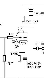

A variation I've tried with pentodes and will be trying with cascoded triodes in the near future is to put a very good CCS on top of the upper cascode element and connect the plate resistor to ground. The CCS provides all the current for both the cascoded triodes (or pentode) and the plate resistor. This shortens the signal path to include only the cathode resistor, the amplifying element and the plate load. The CCS provides very good power supply isolation.
For an example look at the "driver experiments" section on my web page.
Gary

Now that is absolutely Brilliant! I believe you'd also be able to take advantage of the mu output for a low output Z drive too. Going to have to give this a try in the next amp...very sweet; thanks Gary.
cheers,
Douglas

hey-Hey!!!,
I have used different triodes in cascode and liked the result. 6J6 diff amp with a 6H30 on top for instance. I kept going in this general direction, and use MOSFET's on top now...🙂 The MOSFET allows me to avoid some rather questionable operating points the composite would require. I have upped the game to 6H30 on the bottom and cannot afford the 2x Ec2 voltage as a lower limit to plate excursion; now I can get within a few volts of Ec2 and not leave the 'pentode' portion...🙂

may i know your operating point for the 6H30?
hey Tony,
It has the MOSFET gate at ~110V and is passing 15 mA at idle per triode. It is arranged as a LTP over a CCS, and I don't worry about the value of the bias; that takes care of itself. B+ is over 550V, and the MOSFET drain is ~330V( all from ground ). It can take a 6H6pi with only a slight reduction in gain and these are generally better matched section-section( not to mention being much cheaper ).
