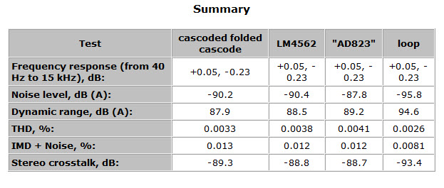

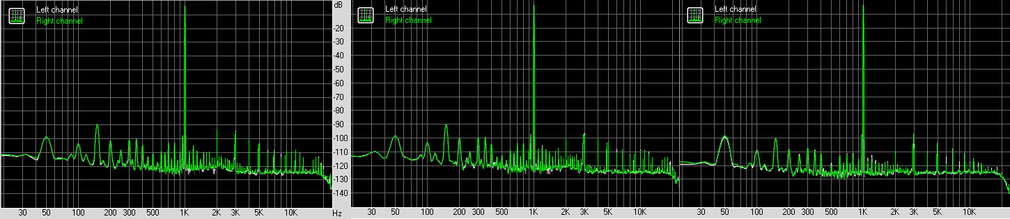

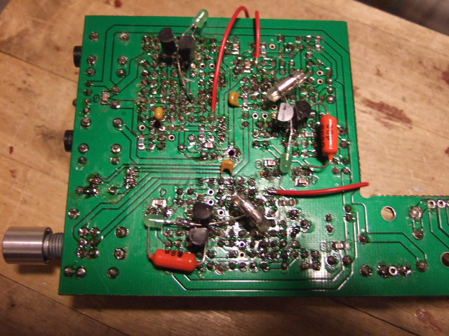

It's been discussed, but I haven't seen it done so I had to try it. In spite of the messy appearance it's stable, low noise and measures well. Measured with RMAA THD is lower compared to the standard arrangement and mostly it's the 2nd harmonic that's reduced. I like the sound of it and think it's an improvement. It makes the sound cleaner and a little bit leaner.

Are j1 & 9 required?
Not required but wanted. I've tried all four input stage concepts - standard, CFP, cascoded and CFP+cascode - and this it what I prefer.

some curious choices there
cfp around high current, low noise input jfet, setting the ~10mA Idss jfet Id at 1.5 mA, adding ~2-3x degeneration re the naked fet's 1/gm - both seem to say you actually don't trust the linearity/square law cancellation of the input jfet's themselves
the diff pair's "cascode" jfets add greater input Vgd 1/gm modulation than the drain R would without the folded cascode - I usually expect a added cascode to reduce the Vswing on the cascoded Q - leaving them out entirely would be better by that criteria
having used the cfp front end you don't use it where it would reduce distortion the most - in a Class A biased output stage
I would move the cfp to the cascoding jfets where the gm boost makes the cascode actually work to reduce input Vds change with common mode signal
and I would use cfp for the output - when used in Class A
and +/-12 V isn't enough for dynamic headroom and linearizing Vbias - I wouldn't want output device Vcb to go below 5 V - as long as it's a descrete circuit why not at least +/-24 V supplies? - with those jfet ccs on the output diamond buffer you need the extra bias V beyond usable output Vswing
at +/-12 Vsupply you could more easily just use an op amp
also I hate selecting parts so I would never use jfet ccs when a "ring of two" bjt feedback ccs just works, on less voltage, with greater output Z, the 1st time with the calculated values - no trimming

no, it is theoretically displeasing. The role of J1/J9 is exactly the same as that of T5/T2. Why devices with opposite characteristics? One of them is not suitable. Consequently, why don`t you want to cascode the input stage cascode as well?
There´s nothing that would make the standard common base VAS rough and muddy (when the voltage gain is kept at a reasonable level).

If this is all wrong, why does it have lower distortion both in real life and in sim?

I incresed the voltage over the input transistors with no sonic difference at all, and it measures just the same.
