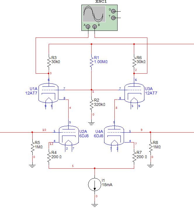

AudioAngel said:Hello!
Now I want to construct a cascode by using the ECC81 tube. But the results a very bad.
Yes they are. The 12AT7 really isn't very good for cascodes. Its g(m) collapses too quickly with diminishing Ip. You'd be better off trying a 6BQ7A. This dual was designed for use as an RF cascode, but it has pretty decent linearity for audio as well (although it likes rather highish Vpk's for good results). It's one of those common TV t00bz, and shouldn't be too difficult to get. It has a high g(m) that doesn't collapse very fast.
Although I'd prefer a small signal pentode. The A Number One problem with cascodes is that the bottom tube operates into a very low load. For linearity, this is not how triodes operate best. You'd get less distortion from a pentode like a 6SJ7, and still avoid the Cmiller problem.
You see cascodes in guitar amps where linearity and low THD doesn't have the premium that it does for hi-fi.

Erik's post sounds good. I'd like building a differential amp with cascodes because then I can use that, what I've tried in a theoretical way by using PSpice. I don't like it to think about something only theoretically.
I think that is a good way. Maybe later I'll build another thing but then I can reuse the tubes so there is no wasting money. 😉
Raphael
Concerning the book. I've found a bookstore. They will import a new book from UK and I've only to pay the normal price without shipping costs.

To sum it up, a cascode has several Problems:
a very high ra (=rout)
the lower tube sees a very low RL, but current can be increased by a paralleling the top tube with a resistor.
Thats the main Problem, because the lower tube should be very linear and hast to work in thet low RL.
I wouldn't go with a pentode, because one advantage of the cascode is that it is free of any noise, but pentodes can be noisy, especially in sesitive preamps.
And, off the records, the ECC81 is absolutly not linear !! It's a nice tube, high mutal conductance, medium high µ, but IMHO not suitable for linear gainstages.
Its has the same system like a ECC85.
IMHO ECC81/85 belong only in vintage German tube radios.

Ups, a little mistake: The 320K resistor should be an 243K for correct grid voltage setting.

As I told you before a cascoded Diffamp is the wrong decision for a line amp.
If you don´t trust me look at one of Morgan Jones books. For Linestages he is always using a plate loaded double Triode with
low gain like 6SN7 or 6BX7.
Or look at some industrial designs, BAT, ARC,
Or look at John Broskies tubecad.com.
Regards Reinhard
Not to speak about the difference in sound of a cascode or a plate loaded triode.

With "textbook" resistive loading, the 12AT7/ECC81 is not linear. CCS loading changes the situation radically. Also, the distortion spectrum of the 'T7 is an advantage in a PP amp. The 'T7 makes a wonderful LTP phase splitter, as the net distortion spectrum is a VERY pleasing "waterfall".
IMO, the 12AT7 is a poor choice in line stages, where it has too much gain, and a poor choice in SE circuits, where its distortion spectrum is unfavorable.
All,
Cascoding the 12AT7/ECC81 is of interest to me. As a H/K Cit. 2 owner, the looming demise of the 12BY7 is most important. A hybrid cascode with a FET on top and a 'T7 with its sections in parallel on the bottom is a possibility to replace the 12BY7 as the voltage gain stage.
I'd appreciate feedback on the hybrid cascode idea.
