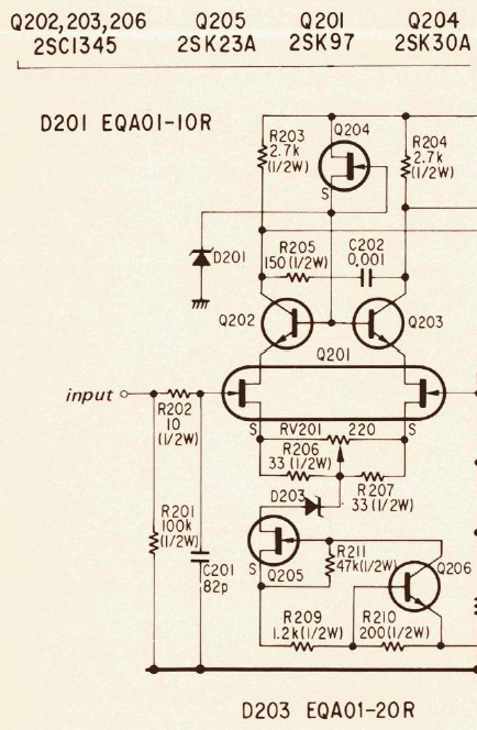

Cascode. When to cascode and when not. Your experience? Examples?
I have tended to use cascode in VAS stages, for single VAS and differential. THe main advantage is to eliminate Early voltage distortion but another advantage not mentioned is that the low voltage transistors dissipate far less power than the common base devices. That reduces thermal drift in D.C. coupled amplifiers (or indeed A.C. coupled) especially when using differential VAS stages.
One difficulty with cascodes is that while they push up the frequency response once the response starts to fall it reduces at 12dB/octave which can make it harder to stabilise. Often this can be compensated, even in circuits which avoid a main Miller compensation (which I prefer) with something like a 10pF capacitor, if needed.
I rarely use cascodes on the input stage unless using FETs to increase the voltage capability. Though I used cascodes in one design simply to use BC237's on a high voltage rail (rather than purchasing BC546's for example).

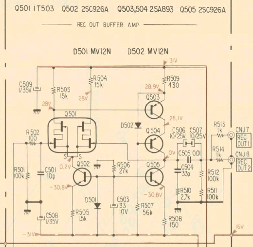

The tonal character of a second part modulates the signal. It will sound a bit more cloudy, more technical, more artificial.
I had plenty of that in my old active filters that were based on single BC850 buffers with resistor pull-ups. I swallowed the whole "ultra-minimalism" thing (and almost died choking!). Never again!
In this case, the tonal character of a resistor and 20V rail was that the BC850's gain was being modulated by the changing resistor current. With an additional BC860 as a constant current source (pretending to be 20M ohm with 1000V across it or something like that), this would have been greatly reduced.

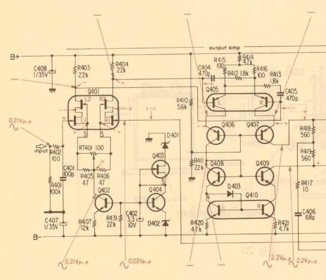

Especially in the first stage, where high amplification is benificial to supress noise and distortion. At given signal levels at that 1st output, supply voltage is not so much important. It's balancing the involved issues.
In the next voltage gain / vas stage, other considerations apply and other choices may become or are very valid.
