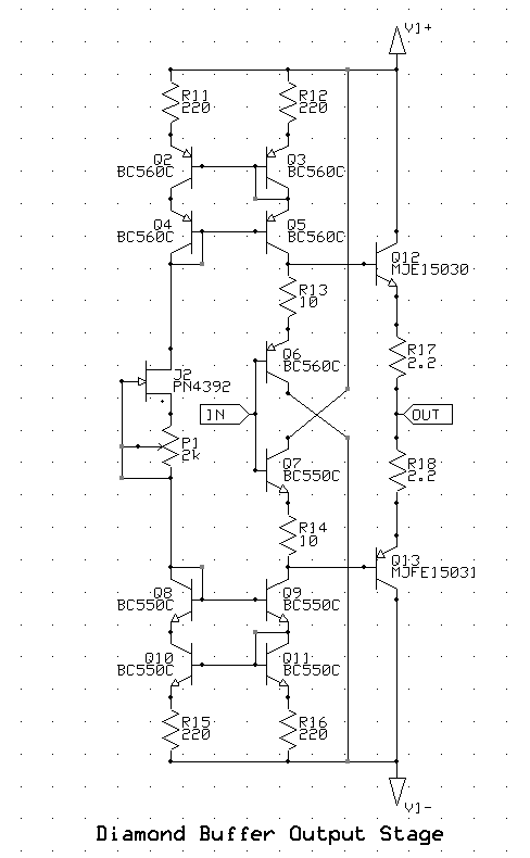

I'm sorry if this is asked before. I've tried searching high and low for the answers but unfortunately they don't have sufficient information. I also searched this forum.

basically, i'm looking to use either wilson swapped or cascode current mirror for my diamond buffer. I'm not sure which one would be better theoretically. Simulations gave me slightly lower THD with the Wilson Swapped.
i also plan to use it for the folded cascode stage on my discrete amplifier. Any suggestions?
Thanks.
This would be an example.
EDIT: I'm looking for a comparison between these two mirrors specifically for bipolar junction transistors. Thank you.

The cascoded normal current mirror/CCS typically has a better transient response (no overshoot), but the Wilson has a bit more bandwidth, at the cost of overshoot. More benefitial to your design might be the use of BJT's with high early voltage (that is, BC5xxA's in your example) for those transistors which have big Vce voltage swings.

So it's better for my buffer to use the Wilson Swapped Current Mirror instead right?
