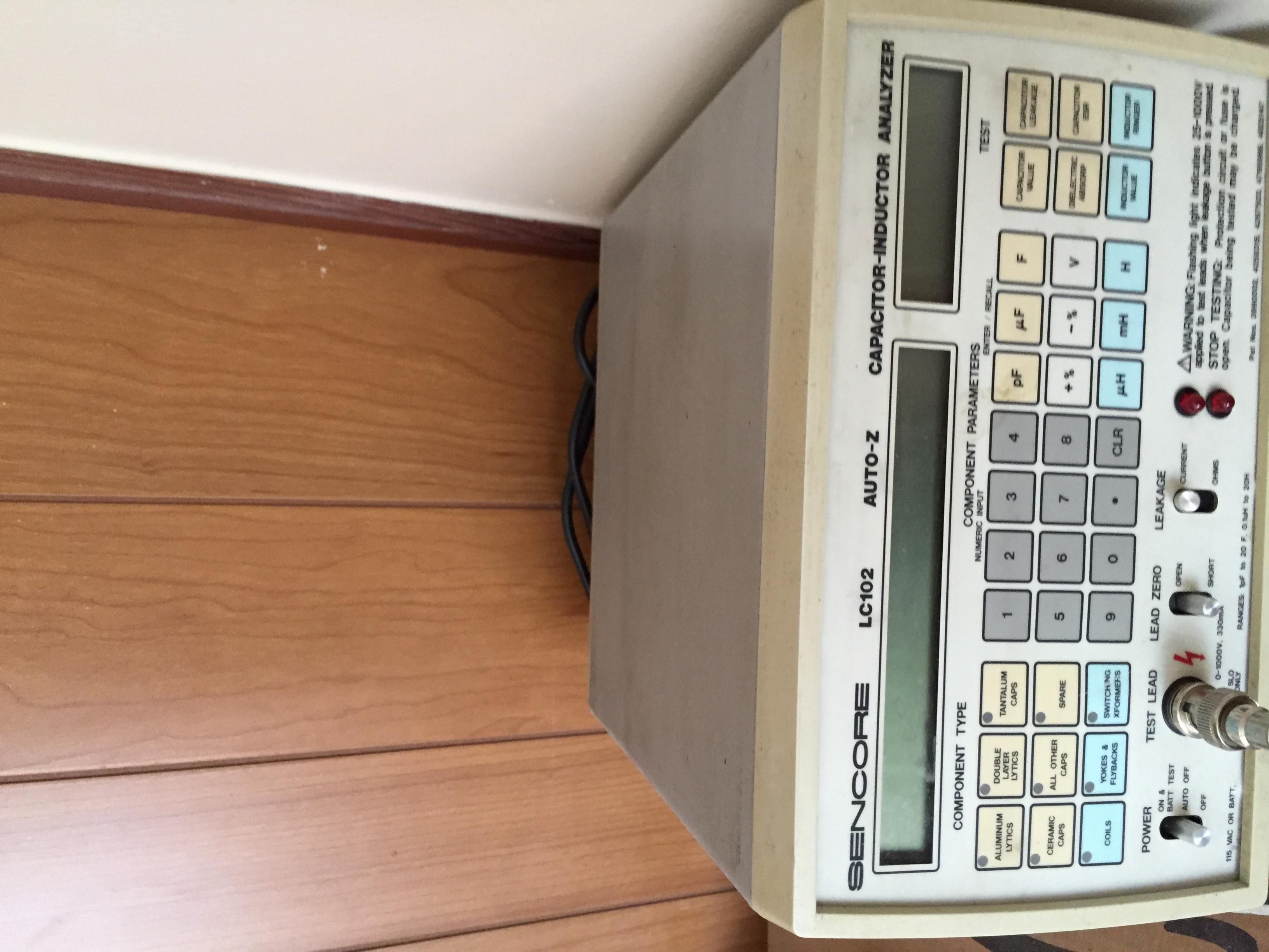

I have a sencore Lc102 which is one of the most thorough cap analyzer ever made. I also own over 284 tube amps and all but 6 are vintage..Now granted many are duplicate mono amps such as Dyna mk3s and Mac Mc60s and Heath w5ms and Eico hf50s and Hf60s,Fisher 55a.Heath W6ms as well as many stereo amps like Leak St50s and Mac Mc275s and Mc240s and the list goes on.

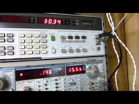

I will be putting up a pair of Mc30s I rebuilt using an all film cap supply and a choke and I can will show you the distortion and power numbers as well as the 1khz,10khz and 20khz sq waves..These amps will make 52 watts using a GZ34 and when I using a 5u4,it drops to about 46 watts..I'm using Rca 6L6gc black plates. I use two different distortion analyzers.
These are the analyzers I use and on this particular amp is an Mc225 and it makes over 30 watts both channels driven. That I just did a rebuild with 820uf panasonics in the doubler and a dual 100uf FT down stream and a single 50uf FT.It says 30.34 watt and the bottom Tek is showing 15.5v and when you square that and divide by the 8 ohm load,it shows the exact power reading on the HP.

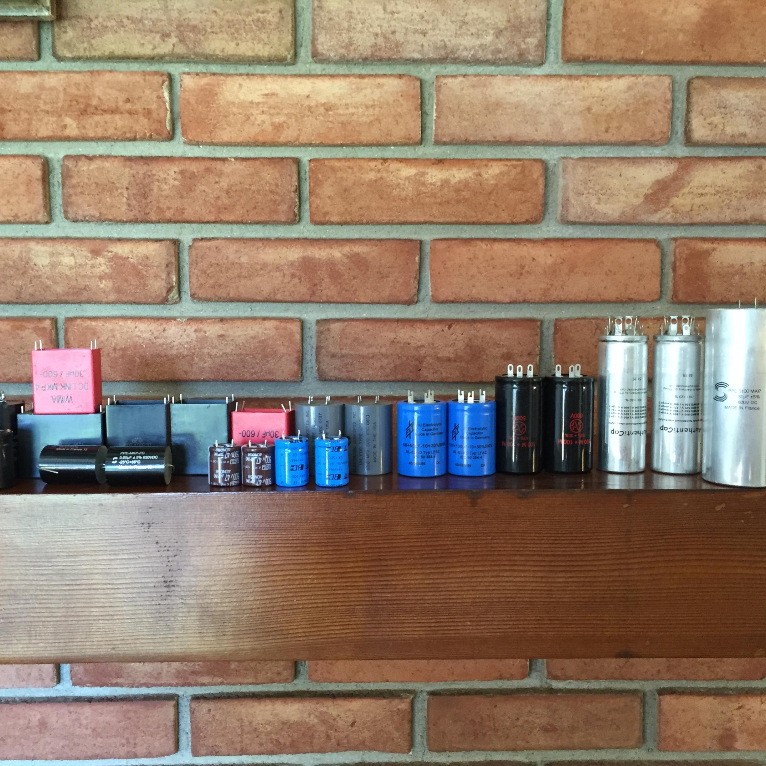

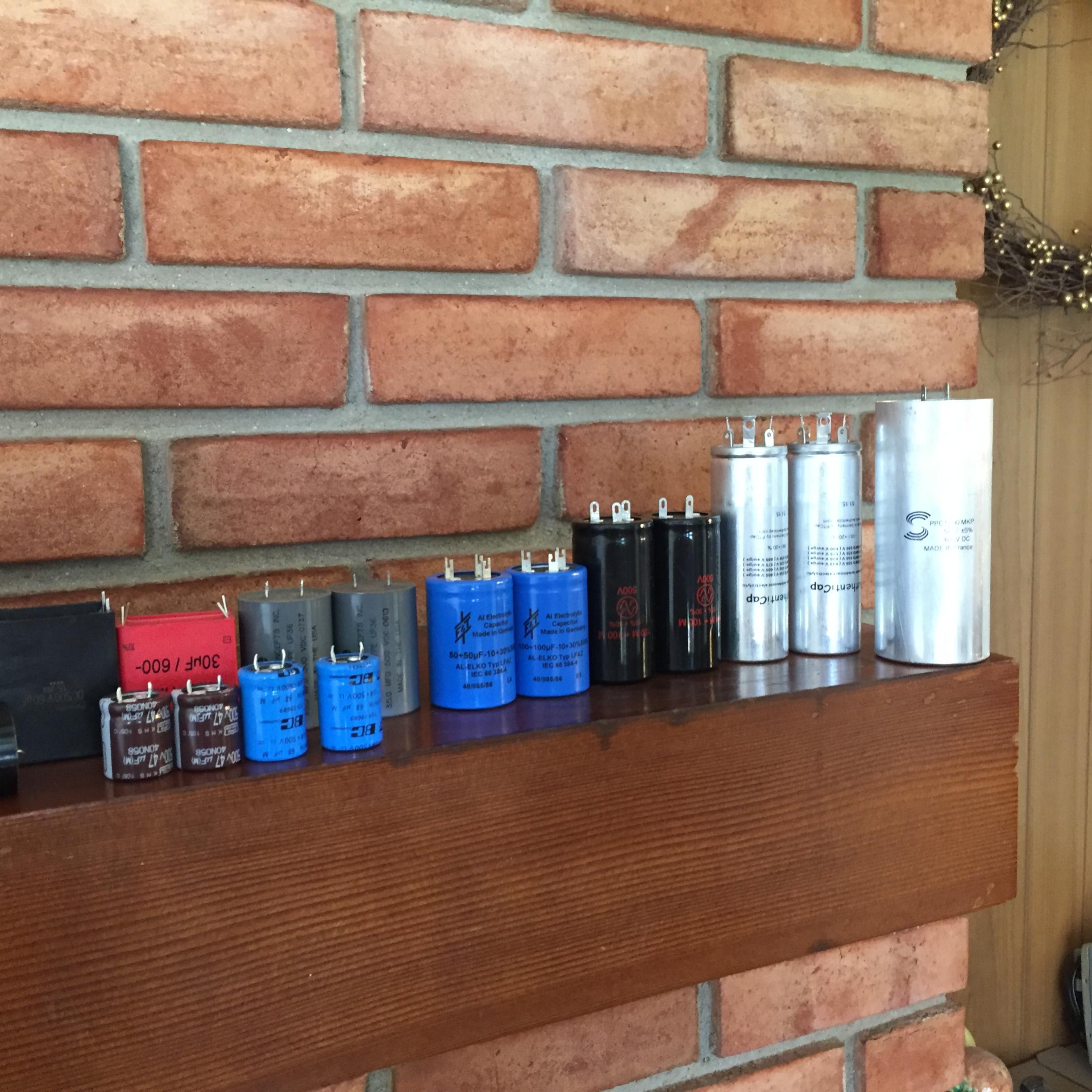

Here are some of the caps I use and you see quite a variety of lytics and film caps and motor runs.I just put of couple of each up to get them in the picture.
