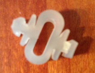

Aargh! One thing at a time. Do you know where I can buy replacements for the silicon shock absorbers that connect the VAM1202 to the drawer assembly? I managed to tear two of them and cannot find anyone locally who sells replacements. I called Cary Audio, but their tech guys confessed that they had trouble sourcing the mounts as well; it seems they aren't included with either replacement VAM1202/12 laser assemblies or the drawer assemblies. Someone must have them for sale...

You can't buy those supports after market. I've tried. There may be something you can use out there, but I haven't found anything yet.
I usually save old transports for parts like this, but I seem to be out of them as well.
