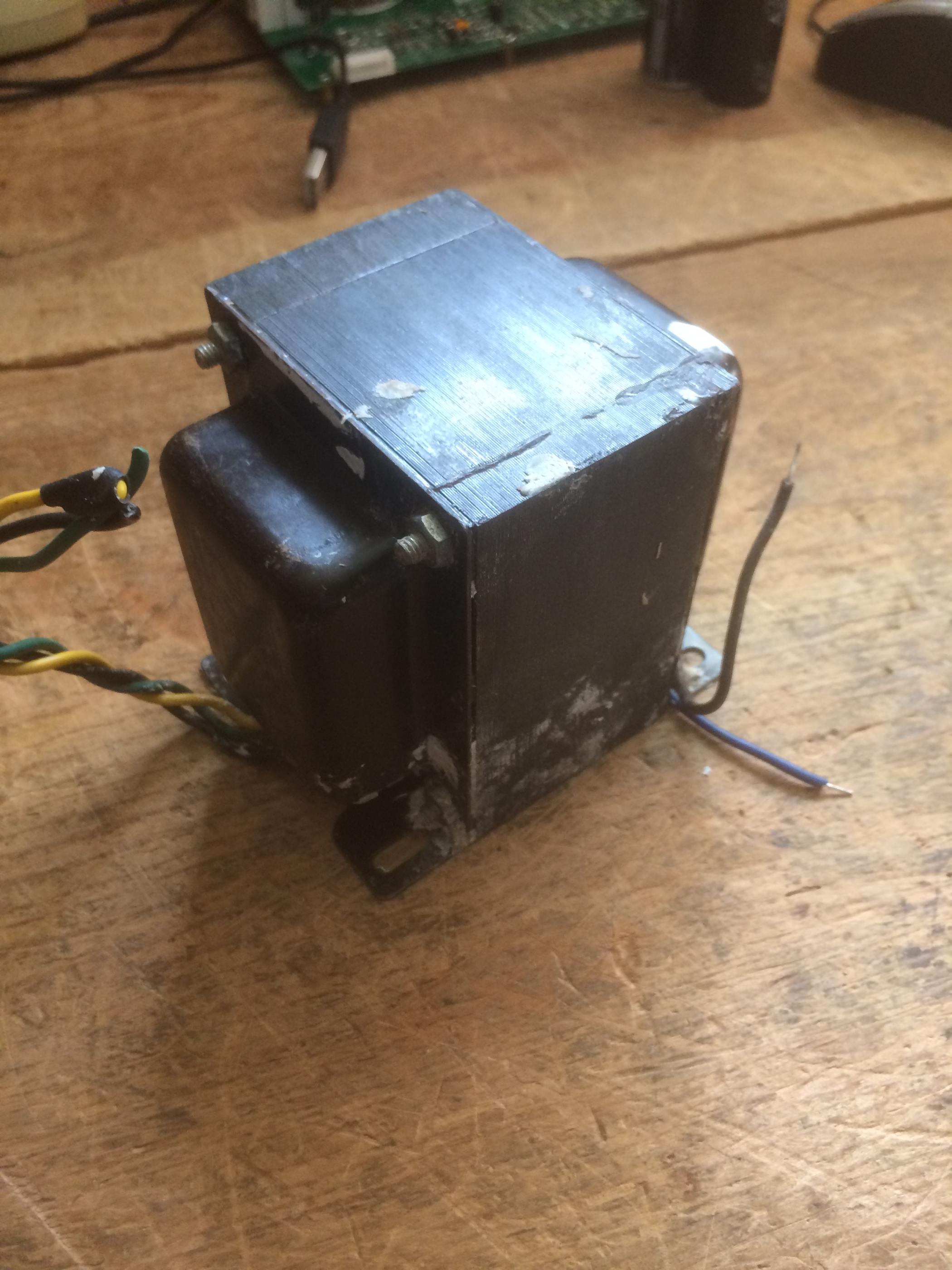

What does the failed "iron" look like? A photo will be of considerable help. See Kevin's form factor remark.

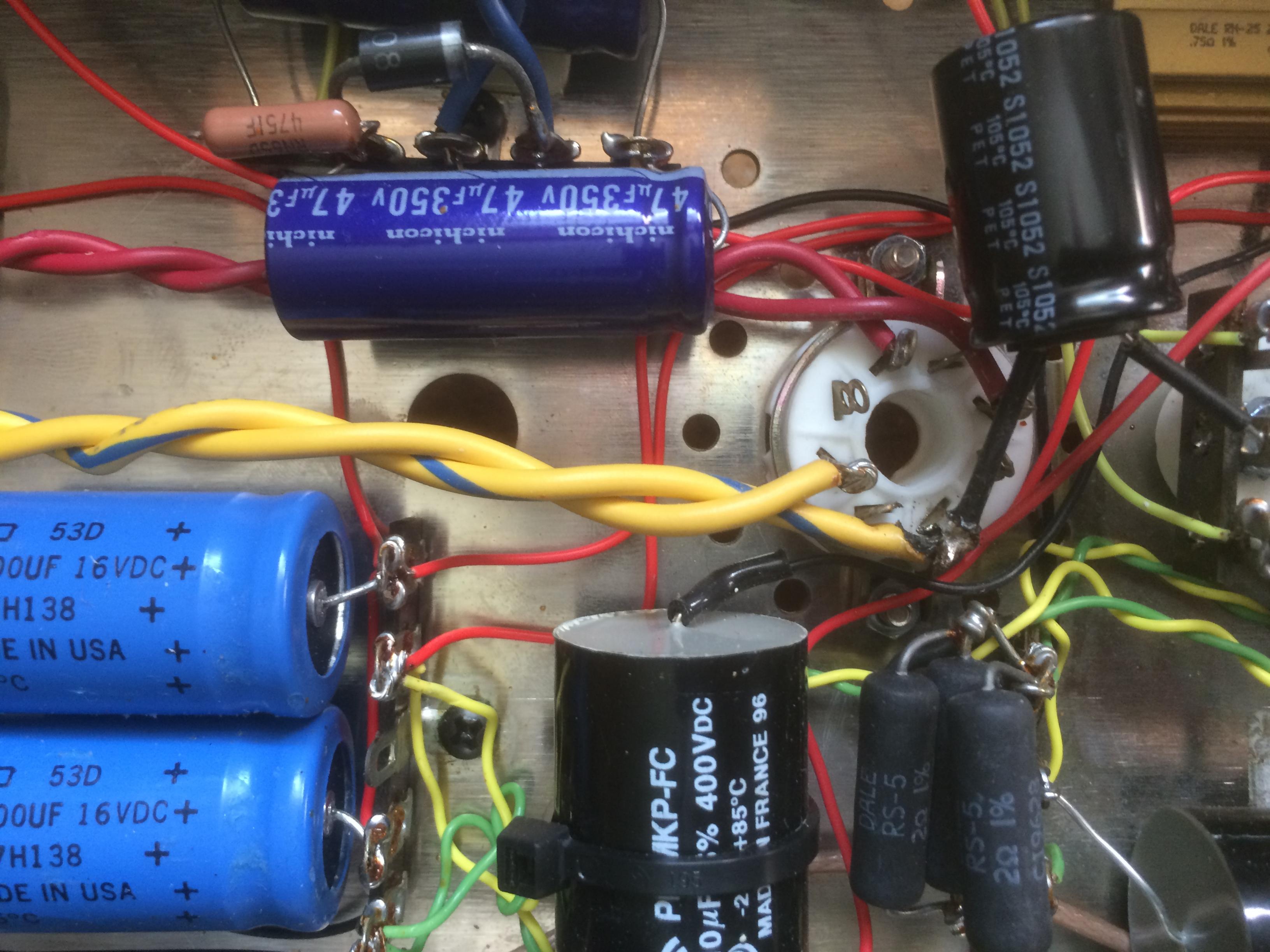

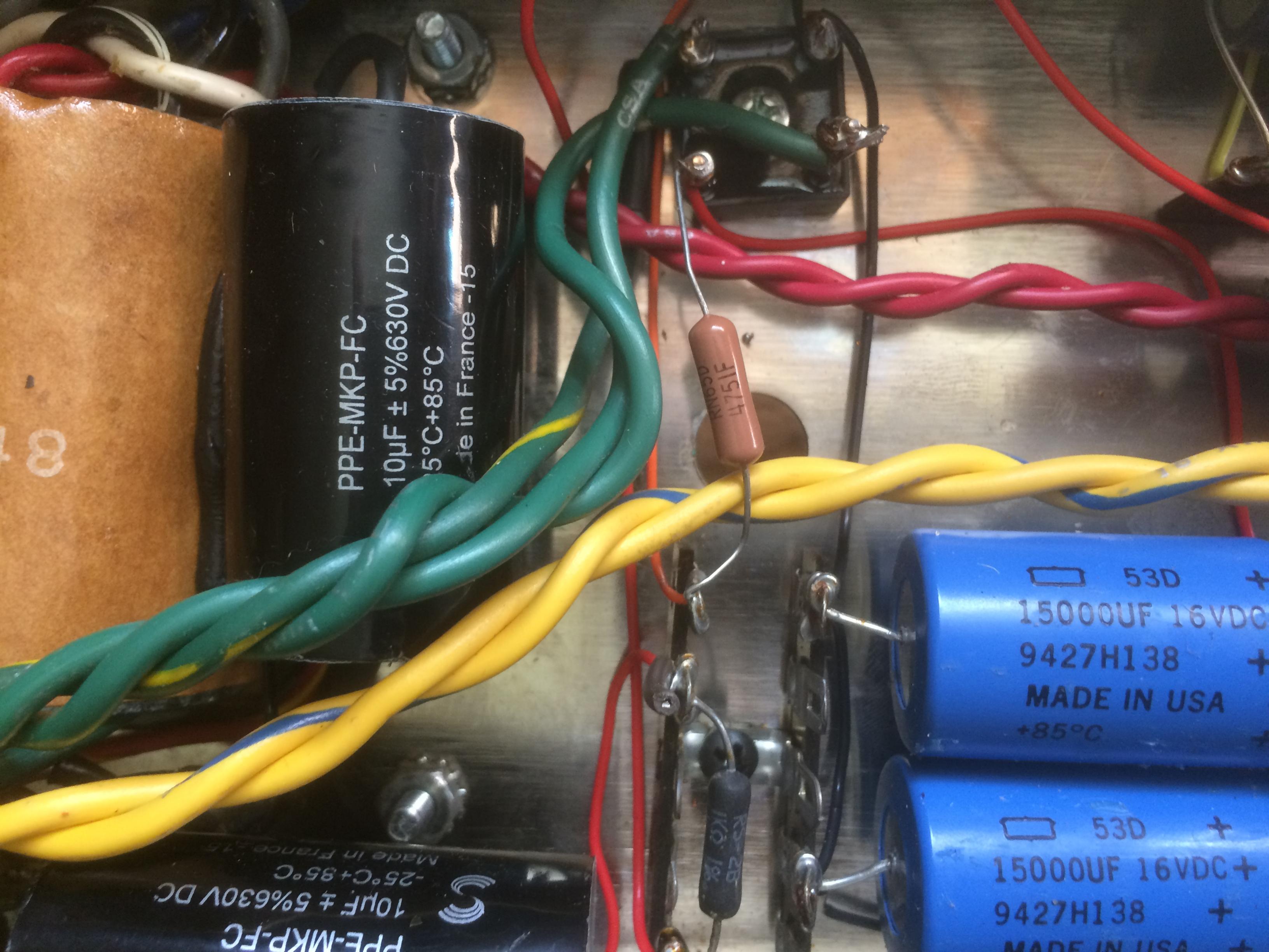

Take a picture of the area of the amp where the output transformer
is connected to the last capacitor of the power supply (Its probably the closest capacitor to the OPT and the 300B tube) and we'll try to help you.

photographs
here are some photographs

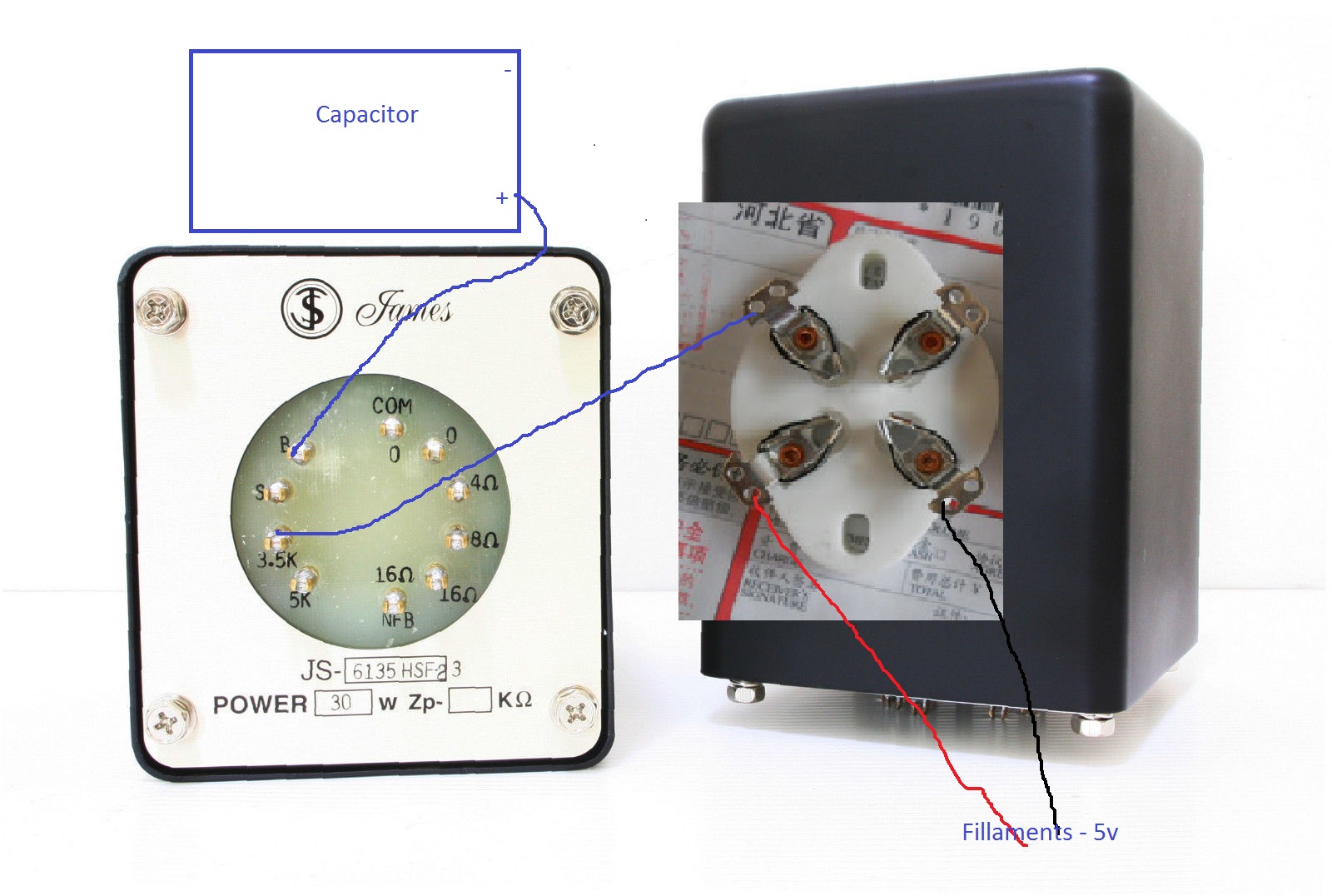

The rightmost picture shows the rectifier tube socket connected to the power transformer yellow wires(5U4 cathode legs 2 &8) and red wires(5U4 anode legs 4 & 6). I Cant figure out from these pictures which is the last B+ capacitor.
When the defective transformer was connected, the two secondary wires were connected to the speaker terminals so with the new transformer you'll
do the same. About the primary wires they should be connected like in the picture below.
