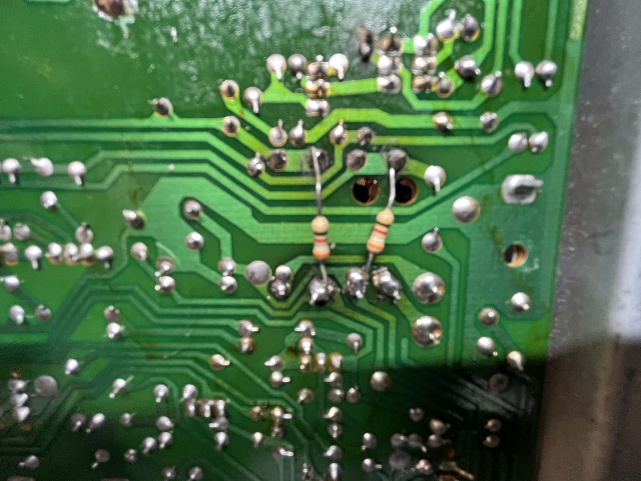

I was thinking about maybe trying to rebuild this, but I have at least one resistor that is black that I can't read the colors on, and the schematic doesn't give values. Can't imagine what damage to the nearby transistors might have taken. Plus the diodes and other things nearby. I could try, but would be wasting money if the thing smoked again.

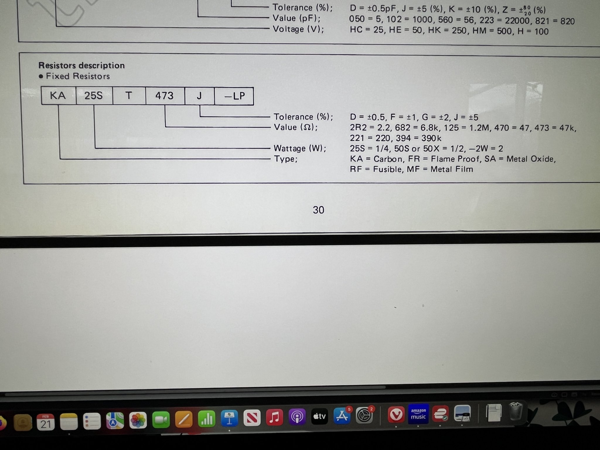

The problem is, that I got it from somebody else, who put some resistors underneath the unit. The capacitor at C623 was bad, so I replaced it with one of the same. That is when it smoked. There is a resistor at R523 or 533 that is black. I don't know the value, and the schematic doesn't give you that. Gives you a supplier part number. What if Mouser doesn't have that one? And like I said, what other components did that surge destroy? You can't copy from the PDF and highlight just the supplier part number to check in Mouser, maybe if I convert it to Word. I don't have Word.

Okay, so basic electronics.
C623 can only go bad again if either the zener is open, or you installed it backwards.
R523 is in the amplifier section and is 27K, highly unlikely to ever burn out, R533 is a 68 ohm part and may burn out, but I would expect the output stage to have failed badly in that case.
What else might be bad? Heck, considering someone else messed with it, and you are not familiar with audio electronics, I guess it is anyone's guess. From your comments so far, I would ask you to consider either paying a proper audio tech familiar with Carver to repair it for you, or give it to someone who will do the same. The receiver is well worth repairing properly and I would hate to see it end up in the trash. What a total waste that would be. Clearly putting some effort into learning isn't considered worthwhile, and I got those values off the schematic.

Yeah, I realized I didn't go down the PDF far enough and there were the values, of course on my copy there are a lot of pencil marks with other values as well in various places. I understand schematics, what resistors and diodes do, etc. Just frustrated because I have many other things to do. You can pick these units up for $100, shipping might be high. Not going to trash it, but I think it will go on the back burner until I upgrade some turntables.
