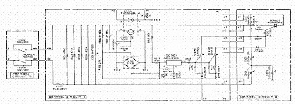

Here's an example of Yamaha's X-Power circuit, an infringement of Bob Carver's patent.
The piano motorcycle company used the "X-Power" in a few 1981 amp models, stuff i saw and heard at the time. (although a 21 year old marine knows squat didly about hand-to-circuit combat)
The triacs are switched by a Sanyo manufactured ig04080, the transformer primaries and ground connections are in the upper and bottom corner on the right side of the centre board.
150 watts in 4 ohms from only two 120 watt Pd output devices.
These amplifiers were only available for a short while, Bob Carver sued Nippon Gakki successfully, afaih.
Notte bade for a commercial marketing guy.

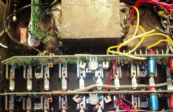

Hi Jason,
What, the Carver or Powerbase?
No pics of a Powerbase (Amcron or Crown in the USA). For the powerbase, imagine a chassis divided mid way to make two shelves. There is a fan placed in the middle (brilliant!). The bottom is dirt and some soot. The top half is a couple rows of transistors (no mica) and lots of carbon on the PC board. Blast marks too! Lots of fun. Replacing the boards is the best option is you really want to repair one. They blow for keeps.
I may have a shot of an okay Carver. Yes, found it. This is a working M 1.5. I don't happen to have any in right now, but most look very close to this. What is not shown are the power supply board (along left side, front to back) and the input PCB where the XLR jacks would go (left side on rear panel close to the supply board).
-Chris
