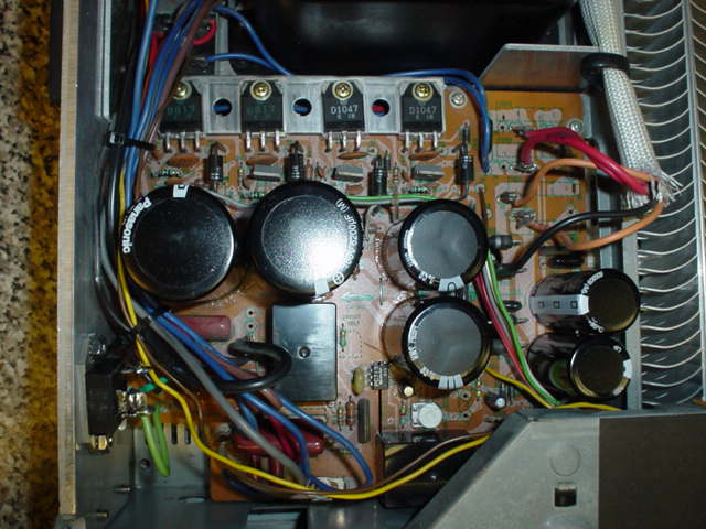

Ok, I pulled the cover on one of the M500's and this is what I measured: From center wiper terminal to the CCW terminal is 150min to 104Kmax ohms, the current setting for 70volts output is 25K. From the center wiper to the CW terminal is 30min to 224K ohms. The fact that you could only get down to 51Kmin seems to suggest that there is a problem. I will include a photo just to make sure the PS caps are oriented correctly.

I realized I was not referencing my pot resistance checks properly, overlooking the center terminal. From the center to the CW terminal I measured a range of 1.4k to 207k ohms. From center to the CCW terminal I measured a range of 8.18k to 118k ohms. I set the resistance to 25k as yours is, which happens to put the wiper back to its original position. From all this it seems that the pot is ok. I also verfiied that my capacitor orientations match yours from your photo. After all this I still suspect that the thyristor on the phase network sub-board is bad. It seems to be a known issue as pointed out in the service bulletin included with the schematic. I still have not had any luck tracking down a replacement. Thanks for your help.
