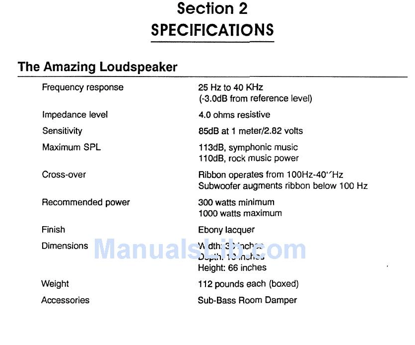

"When I first came out with the Amazing Loudspeaker, my ribbon was four times less efficient than it is now. And the marketplace wouldn't accept it. I mean, I sold Amazing Loudspeakers all right, but not nearly as many as I wanted to.
Even my own amplifiers had troubles driving them, to be honest. You know, if you'd wail on an original Amazing Loudspeaker with one of my amplifiers, which had enough power, sometimes it'd run out of thermal capacity and would go "Click!" The thermal switch would turn it off."
Minimum and maximum power suggestions here are interesting considering the above commentary:
https://www.manualslib.com/manual/892668/Carver-Amazing-Loudspeaker.html?page=4#manual

The exact thing I told my friend was buy a big *** amp from crown, crest or EAW some other monster. I'll need to unpack the info you have given me, he seems set on bi amping - IMHO a clean enough solution cos the XO is a mass of confusion with a bunch of resistors and what not.

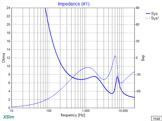

In addition to bi-amping, are you saying you're going to remove the passive crossovers completely and handle the crossover another way? If so:

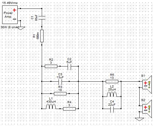

The manualslib schematic shows the series total on the ribbons as 1.5 ohms. If that's the value, it will likely need to be addressed in some way, since removing the passive crossover would make the load more rude than it already was.
Another thing to keep in mind is that if the ribbons are inherently inefficient, removing the passive crossover isn't likely to provide a large gain. If they need 1000 watts to play at higher SPLs because of low sensitivity, that's just what they need.
A lot of the complexity in the crossover is response shaping, and there's quite a bit of it going on. That will need to be replicated some way to maintain the current frequency balance.
Changing the cross point is likely to require different woofer response shaping as well.
I'm not trying to be discouraging, but if a 1000 watt amp is ultimately the solution for the ribbons' low sensitivity, I would definitely just try that on the whole speaker first and see what you've got. Removing the passive crossover and changing the cross point is a significant undertaking, unless you find someone that's already done exactly what you're proposing.

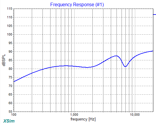

Quick XSim model of the ribbon section electrical response based on the schematic at manualslib (assuming I read it all correctly):
Yes we were doing an external XO - an Ashly 2001 that someone on the carver facebook group used. We contacted him but got no response yet.
I'll suggest that he wait for his info or someone else to mention what they did, you have been great. Atleast we stopped short of screwing up something that's OK now, just needs more power, which really was my first suggestion to him.
